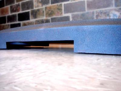

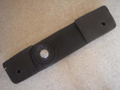

Hello all,
I have been working on a subwoofer enclosure for some time now. I didn't want to use the passenger footwell area or the space behind the seats so I fit a 8" shallow sub from Pioneer (TS-SW841D) into an enclosure that is the same shape and size as the rear storage compartment. I have one installed in my Boxster receiving 200 watts and it sounds great. I will be putting one for sale on e-bay shortly as I know that quite a few of you Boxster owners want a better sounding system. I attached some pictures so you can see what i did. Also attached is a picture of some sealed enclosures that I made to fit some 6-1/2" speakers in my doors. What do you guys think?

Looks nice....probably sounds even better!

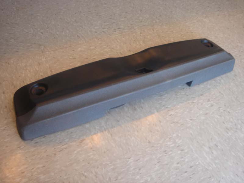

Did the 8" shallow sub have to be offset from center because of the depression in the housing that has to provide space for the latch hook?
Regards, Maurice.
Share this post
Yes. It would have looked better if the speaker were in the middle but you are right, it is impossible because of the depression you mentioned.

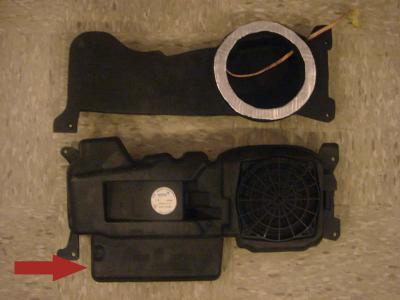

Are the door enclosure the originals, but strengthened?
Looking good

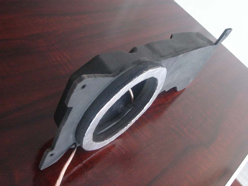

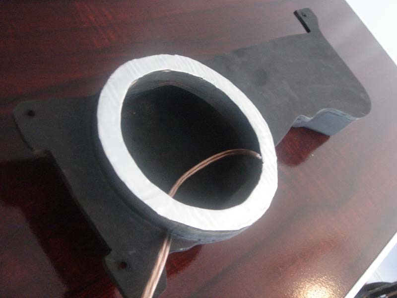

No they are not the originals. I made them from fiberglass, mdf and the mounting ring is plywood covered with sound deadening material. They are sealed enclosures and extremely lightweight, not ported and heavy like the oem. I made them to fit the door cavity just like the factory enclosure with the exception of the bottom part.They replaced some baffles I cut out when I first got a pair of 6-1/2" speakers and the diffrence was incredible!

That's Awesome work! DO you have a baffle template, or more pictures?

Here are some more pictures of the door enclosures.What you see is not just a baffle that holds a speaker in place, it is a speaker box. What I didn't like about the baffle is that there was no way to control the sound waves coming from the rear of the speaker. And there are a lot of problems associated with that. Even free air speakers were meant to be installed with a separation from the front and rear of the cone.

I have sold several pairs of door enclosures over some months now. They are made to fit 6-1/2" inch speakers and have a max depth clearance of 2-7/16". Although I cam make them for any size speaker smaller than 6-1/2".

As far as the 3-1/2" rear fill speakers in the sub box, there is space for them but its not as easy as making holes for them and screwing them in. I would have to make a separate chamber for them inside the larger enclosure. I didn't put them in the original box I made for myself because I didn't want the rear speakers in my system. But they can fit with some modifications.

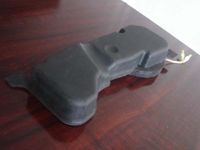

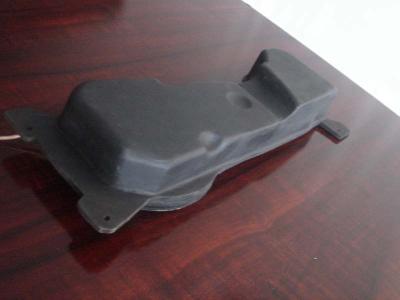

If I can remember correctly, the internal volume of the subwoofer enclosure is about 0.5 cu. ft. I'll measure again to have an exact number for you. The door eclosures have .05 cu. ft. or 95 cu. in. I started selling them late last year for $125 shipped. I'm sending some to the UK this week for a little more just to cover the shipping difference.
2 eight inch woofers will not fit because Pioneer recommends .4 cu. ft. for each woofer, which is about all I can get out of the enclosure.
The sub enclosures that I'm making are copies of the one I made for myself a while back. I wanted only one eight inch speaker because to me it's more than adequate for a small cabin. That's why there is no rear speakers either.
