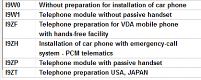

Just purhcased a 2003 Cayenne turbo and the only thing I can't figure out is if the phone module is broken or simply not fitted to our new car.
What option code should i look for on the sticker to know whether I have it or not?

It would be helpful if you tell us what country car we are talking about. The phone options/service varies from country to country.

Sorry, it is a UK car.
Having been through all the codes in the bookelt and referenced that site it seems I don't have the phone module afer all sad.gif
