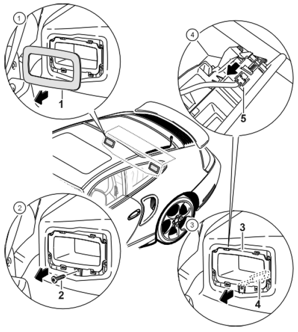

Removing the BOSE speaker enclosure
Removal Instructions
1. Remove the cover trim 1 at the left and right towards the front.
2. Unscrew the fastening screw 2 at the left and right.
3. Pull the sound package 3 in the direction of the arrow out of the bracket 4 and fold over.
4. Disconnecting the plug connection. Press plugs 5 together and pull apart.
Then lift the carpet/foam cover. You can see the strut mounts in each corner.

That was the directions that I was missing! Perfect!

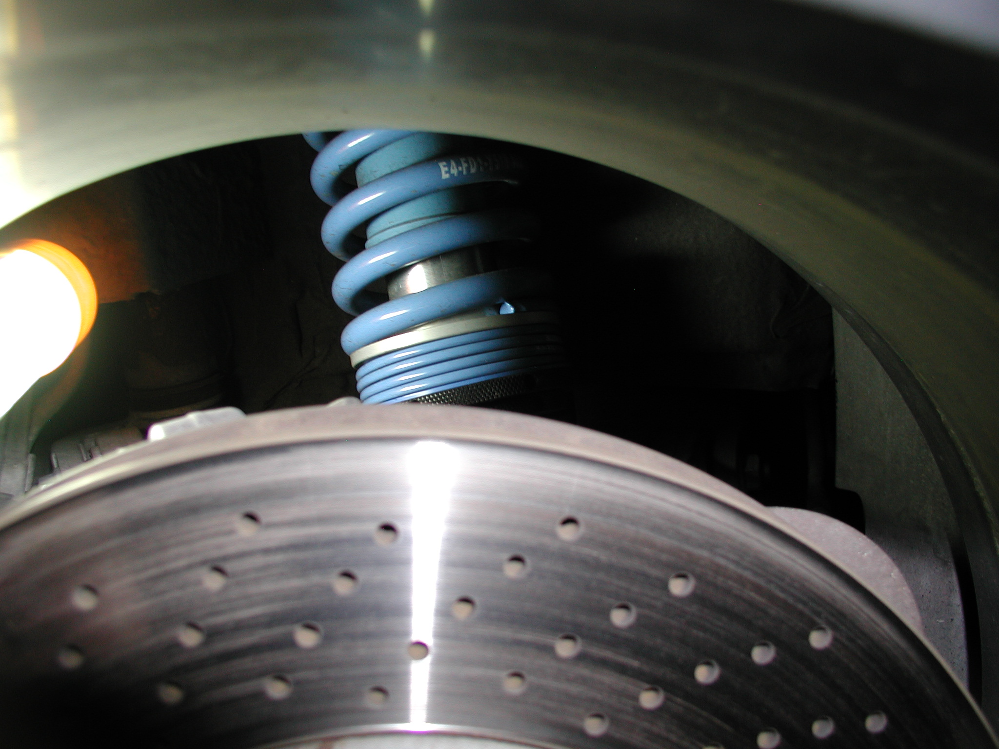

Never having seen these installed on a car, does this look normal? There's a secondary spring on the PSS10's and with my car sitting on the ground it's practically bottomed out, doesn't look like that secondary spring can even move. Is that normal? I had them installed at a very reputable local shop, owner was even a crew chief for a Porsche Cup car... the only reason I'm questioning is that when I wentto adjust the rears (Thanks to you Loren) one side of the Bilstein adjuster was maxed and the other was Full Soft... seemed like a pretty rookie mistake.
