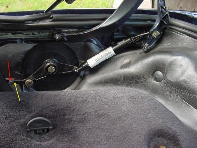

Timbo:
You can see them and access them with the top in the service position.
Here is a photo of where they are located (click on the photo to blow it up):
The red arrow is pointing to the 10mm bolt with fat washer.
The yellow arrow is pointing to the point at which the two metal parts of the pushrod are joined. Be sure to mark this spot with some nail polish or paint so that you have your original starting overall length set.
The effect on the leading edge of the top achieved by lengthening the pushrods is NOT linear, so be careful. At a certain point, the leading edge of the top will start to retract from its maximum forward position.
Once you get close to the distance you want, use the plastic ball cups to make a finer adjustment.
Regards, Maurice.

Tim:
It looks like your pushrods may be set just past the point where they end up placing the leading edge in the maximum forward position.
Make a fine adjustment in both directions and see which way starts to yield an improvement in the final position.
