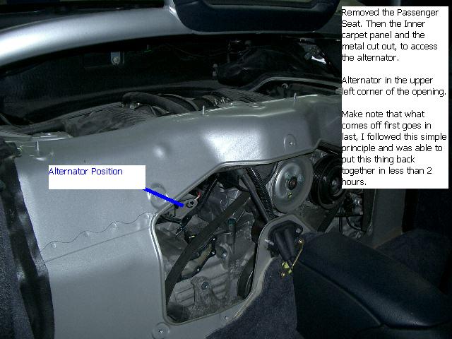

I finally got the whole thing figured out and fixed. Gathered up the courage to take the job up myself, took apart the Alternator - what I found is very interesting...all I had to do was replace a voltage regulator and the Alternator worked like new!
I took pics of the whole process, will post it here in a couple of days along with the part # etc - I'll send you a note informing you as soon as I post it.

Replacing the Alternator on a Boxster is easy for anyone who has a basic toolset and about 2 - 3 hours to spare.
Take a few minutes to read the following note before you purchase a new Alternator. A new alternator can cost you anywhere between $500 to $800, but 10 minute check can save you hundreds. Here's how:
Alternators have 4 major components:
* Alternator core (the wire winding and the entire Alternator body)
* Bearing (what the shaft and the pulley rotate on)
* Voltage Regulator (rectangular component on the back side)
* Rectifier (Horse shoe shaped component on the back)
If you know that the Alternator is bad and has to be replaced, first proceed with the following tests:
* Check to see if the inner wire winding look OK (clean) and does not smell burnt (if this case your alternator core is OK)
* Check to see if the pulley (what the belt sits on) rotates smoothly and freely. (if OK it would mean your bearing is sound).
If your core and the bearing are booth OK, chances are that either the voltage regulator OR the Rectifier has gone bad. These will cost you anywhere between $20 to $80.
On a bad Alternator chances of a faulty Voltage Regulator are rather high, but to be sure you can simply unscrew the regulator OR take the Alternator to Auto-Electrician - they can tell you if the regulator is shot. In this case you can simply replace the regulator on the old Alternator.
Here is the simplified version of the Alternator OR Alternator component change procedure:
* Access the engine bay on the Boxster
* Remover Passenger seat
* Remove carpet panel and the front panel cover (see pic)
* Remove the Belt
* Unbolt and remove the Alternator
* Replace components (Regulator OR Rectifier) or New Alternator
* Follow: Put in first what came out last.
Good luck :thumbup:

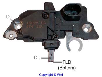

More regulator info. http://forums.rennlist.com/rennforums/show...light=regulator
The Transpro part number IB225 regulator mentioned in the renntech post #15 appears to be the best deal. It replaces Bosch F-00M-145-200, F-00M-145-209, and F-00M-145-225.
A.S.E Supply had a special on it for $21. http://www.asesupply.com/ But I do not think this company sells retail to the public. If you go to the Transpro/WAI sit you can cross reference the part. http://www.wai-wetherill.com/home.cfm
Huco also has parts and if you know the Bosch part number you can do a cross reference. http://www.hueco.de/

More pics - close up shots of the Alternator / components
Great work on finding the regulator over at the Benz shop. Porsche does not list it seperately. You wouldn't happen to have any info on the rectifier being available at the Benz shop too would you?
Eric
Transpro has the rectifier listed under their part number IBR200 for 1997-2001. Applications listed are Porsche, Opel, and Saturn. You can cross reference the Bosch part number to make sure.
