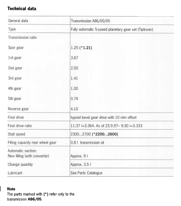

Update
2001 transmission work flawlessly with the old 1997 control module.
but the tranmission ratio seams a bit different then the old one... I've hit the 30 miles per galon with it...:thumbup:
Total cost $3000 with tranny, IMS, RMS, and Air injection valve... not too bad...
Special thanks to Loren and RFM

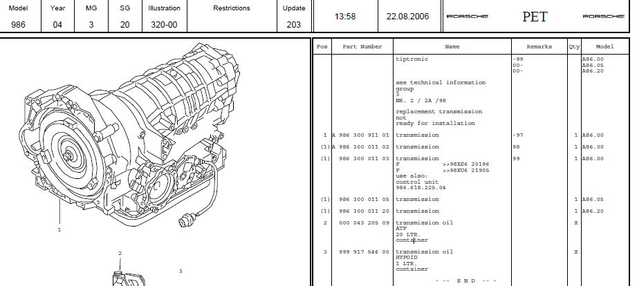

Loren... Is this spur gear located between the transmission and the final drive????
If the ratio is different, that's probably why I have almost 6 KMH difference at 3000 RPM...
Thanks for the Help
