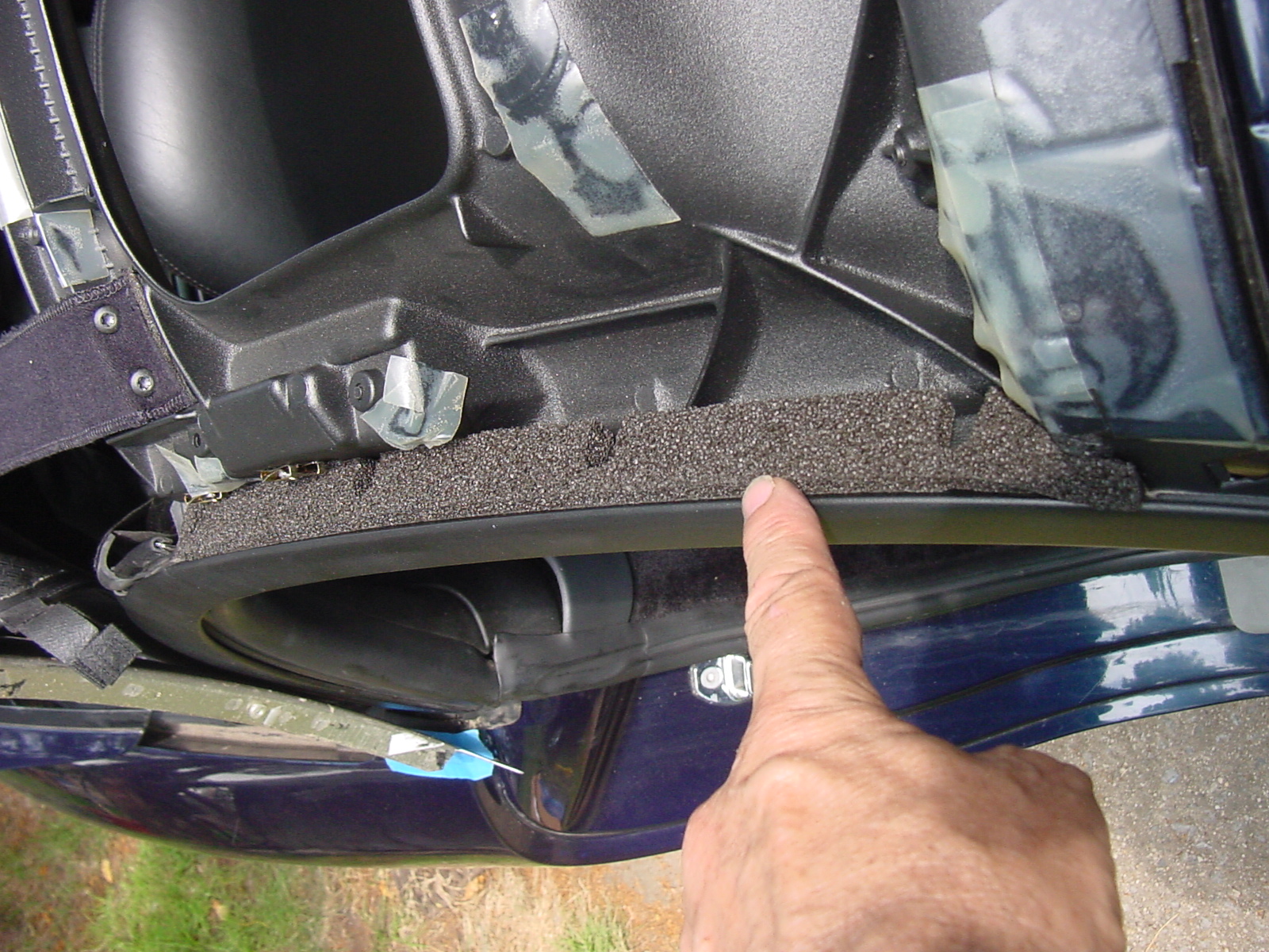

Here are two photos of what the foam material is supposed to look like and the exact installation points:
(with adhesive backing still attached)
(installed)
This was a factory piece that only came as part of a kit that was included in an OEM canvas top replacement from Porsche. Since it is not available separately, you should be able to make it from that Home Depot foam rubber. Just make sure it's closed cell foam and that it compressed to about 1/8th of an inch thickness when it is squeezed down by the shoulder plates.
