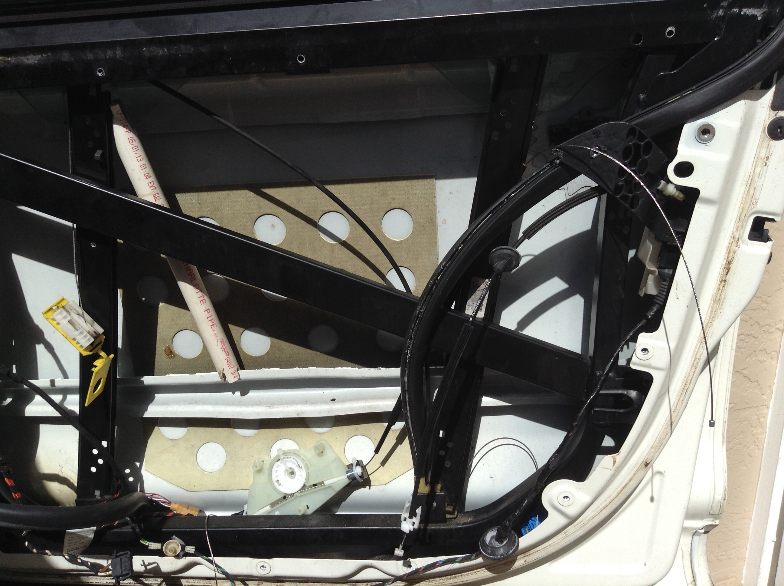

Old thread but relevant. Need some quick help here – I was supposed to leave on a really important trip this morning, but I rolled up the passenger window and heard a snap/grinding and now the window won’t even stay up.
I just want to get it open so I can tie up the cable some how to keep it firmly closed, but I can’t get the **** inner black steel panel off. I took out all the bolts and the 4 big rivets along the top, plus two very small ones that tack it to the frame of the door on either side. But there is something holding it on in the area near where the door cable comes out. If I bend it out and look down I can just see some levers and such still attached to the steel plate. Its somewhere in the area in the picture – is mine different some how? Of the three blue arrows the top is a plastic clip but the others are rivets. Also there is an ominous looking rivet you can see down an access hole in red. If I drill these out I don’t think I will ever get it back together in time. Does any of this sound familiar to anyone? Much appreciated. 2004 CTT.
I tried duct tape, but going over bumps it would just fall...there is no support for the window right now, and I have to drive for several days.
Wedges are a good idea, but I am so close - I can see the cable where it came off, if I could just get this panel off I could clamp it up solid. I did find one other person online with the same problem, but there were no responses. Can't find this in parts diagrams either - what is it those to rivets hold? Maybe I should just drill them out and pay the consequences later...
Hi temporarily a wooden wedge on the outside, long term u need to drill out all the rivets and there are quiet a few those three need replacing with a screws, I've got a couple of posts in this forum and the other one the kit to fix is 20$ eBay but a pita. I have both mine stripped down at the moment I can give you advise no problem
I'd still go the temporary fix route. The door locking mechanism is in the vicinity presumably and it would be most unusual that Porsche would install rivets which have to be removed in order to gain access to the window regulator.

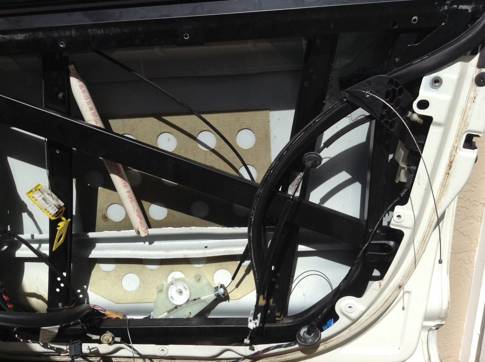

Thanks for the pictures, I think I am going to try the same today. I did manage to bend the steel panel away far enough to grab the broken cable, and I tied to a strut in the door. The window sags a little but it is possible that it would last the trip.
I can't get just the cable today, but I did find the regulator assembly in town that includes the two bars; expensive but available. Since I can't fully see how the bars are mounted, does it look like they unbolt? The part I can see looks welded. I have to decide whether to try the proper repair, or to just go with the tied cable and do it when I come back. If I do get the panel off and I have the kit with the bars, is it fairly easy to replace?
If I repair, I have to get the steel panel off. In this picture, I think what is keeping it in is where this bracket attached to the steel panel. Did yours have rivets there PK? Or maybe it is the bracket above. Mine looks different somehow.
When I get the kit I can look how the cables are attached.

Sort of progress - there is no way I can get the bars installed fast, so I grabbed a brake cable from a bicycle, replaced the broken one and I am trying to get it back together. Fortunately it is the down cable so not as much stress, I just tied it around the window attachment point. So basically doing the cable replacement as well.
Question though - how tight should you make the cable? The box with the spool has two springs on the ends, do you compress them fully? I guess they are to take up cable stretch...thanks.
