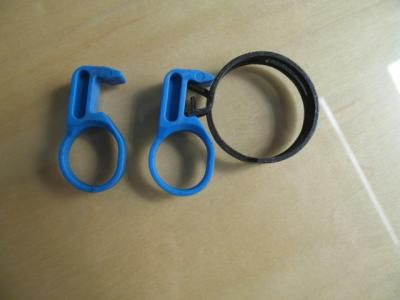

get a generic hose clamp to attach the tube to the engine-side when you replace your AOS. i'm 5'11" and I got scraped and bruise trying to use OEM clamp and was unsuccessful.

Thanks. There wasn't any smoke the last 20 minutes or so of my ride, just squealing, so I should be good with that respect. I'm buying a new boot and will just cut the old one in half if I need to :) I'll have to see if I have any pipe clamps; I'm pretty sure I've got some laying around, but have to figure out where I put them!

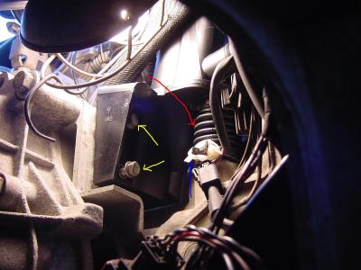

Reinstalling the factory-style clamp on the bottom of the bellows tube is just a matter of getting just the right angle of attack from underneath the right rear rotor (with the rim removed) with the car jacked up at just the right height. Here's a photo of the view that that angle will provide with the red arrows showing the two 10mm bolts and the yellow arrow pointing to the bellows:
(Note that in this photo, the bottom OEM clamp has been squeezed and tied up with strong zip ties to hold it open for installation)

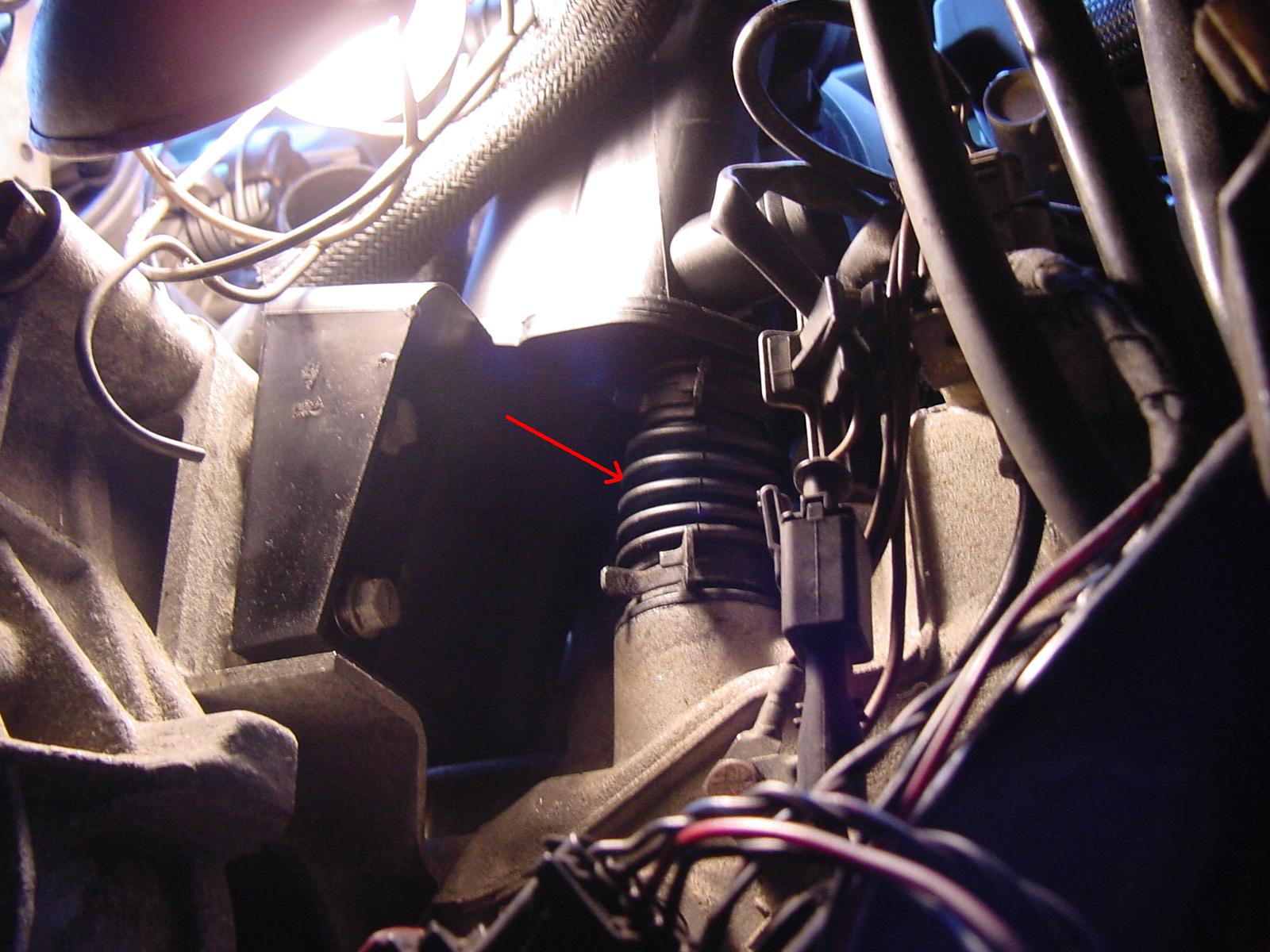

Here it is installed:
