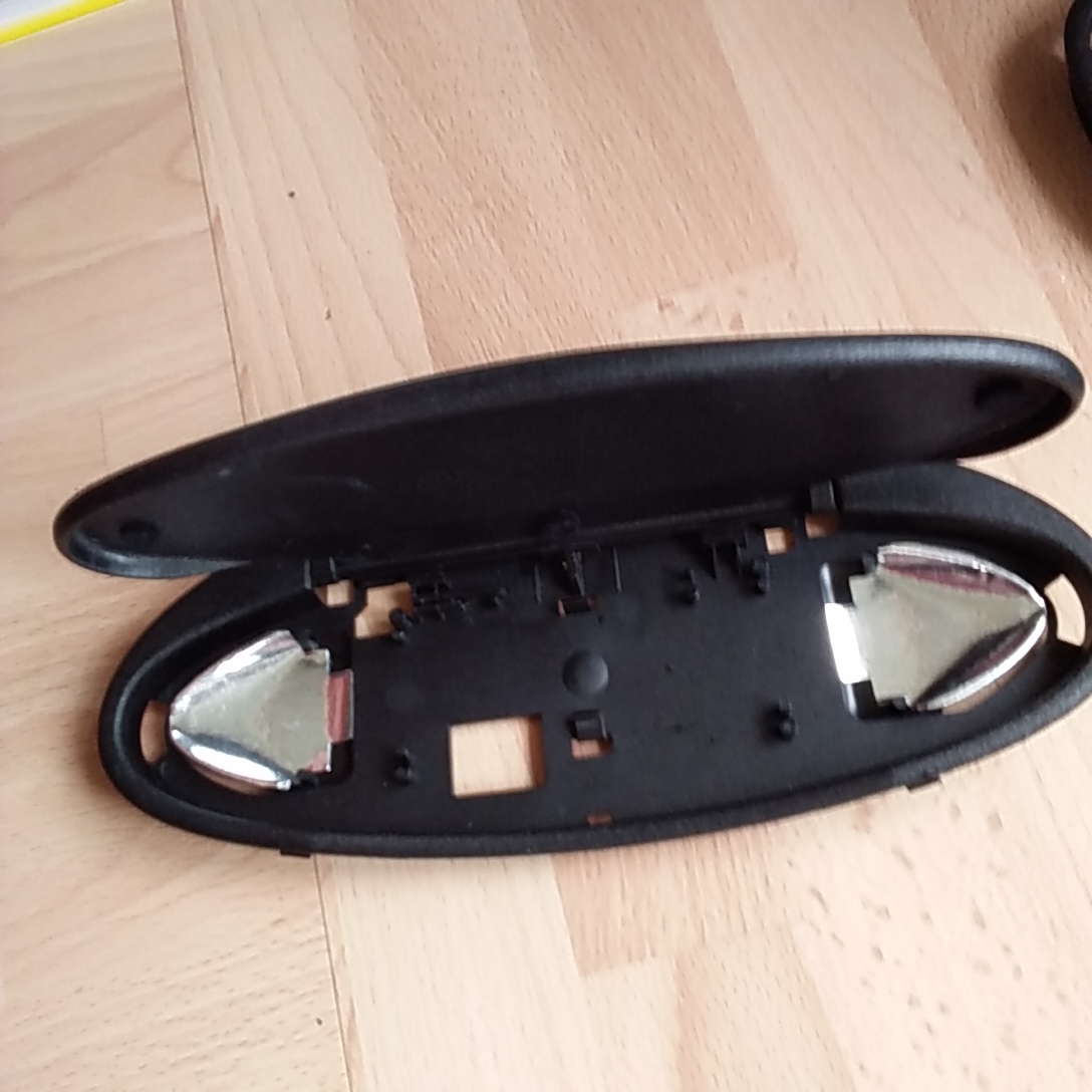

Today I fixed my broken sun visor flaps. Mine were broken in both places, ie.the pins that hold the flap in place broke so they fell off completely, and the metal spring horseshoes broke off so the flaps won't stay up when open.
I only replaced the hinge pins as the springs are too far gone. Will use tiny velcro pads to keep the lid open for the time being. Below is the steps I took to fix the hinge pins.
I took some steel nails (1.5inch) and cut down to a small pin size. Then cut half the nail head off to make more of a semi circle shape. This was all done with some metal cutters. Pliers also.
Next I drilled small holes in the plastic where the old pins used to be. The new nail pins can now be inserted from the rear and into the lid to keep it in position. Best to put the lid in place first and then instert the pins.
Last I used a small glue gun to keep the pins from falling out.
Job done. All in all took about 30mins.
