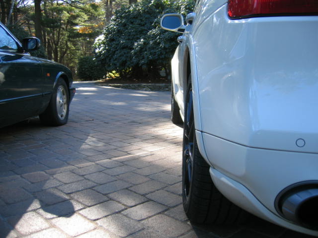

White Cayenne TT w/ Sport Design package, black grill inserts and now with black GTS-style wheels.
I'll post some pictures later, but trust me it looks fantastic.
