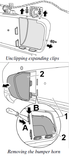

On US/Canada 997-1 cars the bumperettes are held on by tabs and pins that you can only get to from the back side of the bumper.
Thanks Loren,
So I will need the bumper off to remove them?
I have a few scratches on one, was wondering if I could just take it off to drop off to a body shop but I guess it will be easier to get repaired on the car than off it.
+ great job on the update of the site Loren, have been absent for a while but love the work.
Sam
