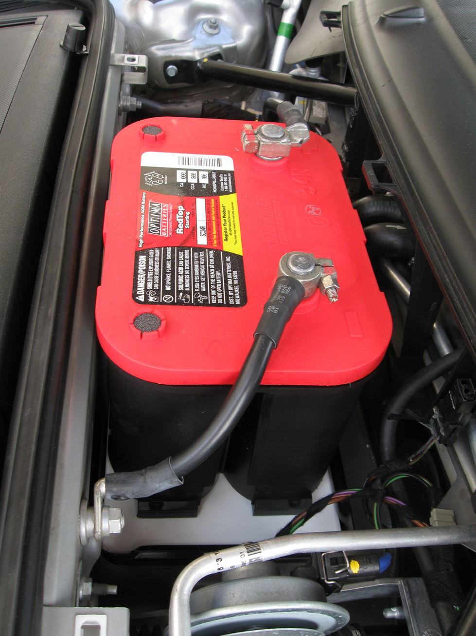

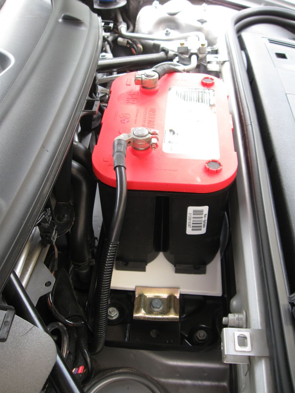

The other weekend I finally got around to installing an Optima battery to replace the original 5 1/2 year old Porsche battery in our '05 997. I made a simple mounting base for the Optima 34R from 3/8" thick HDPE sheet. I plugged my CTEK 7000 battery maintainer in to the cigarette lighter socket hoping to maintain radio and other settings while I disconnected the battery. After removing the battery, I was amazed the trunk light stayed on, so just for grins I pulled the lever for the rear deck lid, and was amazed it actually popped open - without a battery. Then I pulled the lever for the front trunk and heard the click noise, even though the trunk was open. The bottom line is you can open the front trunk with a dead battery using one of these chargers, which has a built-in supply mode!
The Optima 34R fits in the 997 just as easily as in my 986. It's easier to remove the left and right plastic covers as well, and these come off easier than on a 9x8. The trick I remembered was to take off the ground cable, install the battery, then reinstall the ground cable and orient it so it's long enough. I tied off the vent tube out of the way in case I ever put in a conventional flooded battery. Otherwise it's just like installing any other battery.
I've got some of the 3/8" HDPE sheet left over, so if any RennTech contributing members near me want one, let me know and a piece is yours for as long as I have any material left.
Here are the pictures of the completed install

Nice install and excellent tips!
How is the battery fastened to the HDPE plate?

10-24 x 1 1/4" stainless steel flat head phillips head machine screws (quantity 4) from the bottom of the HDPE plate. The screws aligned with the holes on the Optima battery, then a washer and #10 stainless lock nut. I countersunk the screw holes so the heads were flush with the bottom of the plastic. Very simple, but easy to just unscrew the 4 screws in the future, replace the Optima with a new one, and then screw it back together. I made the mounting plate the same size as the old battery so I could just use the existing Porsche mounting clamp. It was about 12 1/4" x 6 7/8", same as I did for my 986 in this topic

Thanks for the detailed explanation. I didn't know the Optima had ears that you could screw into.
