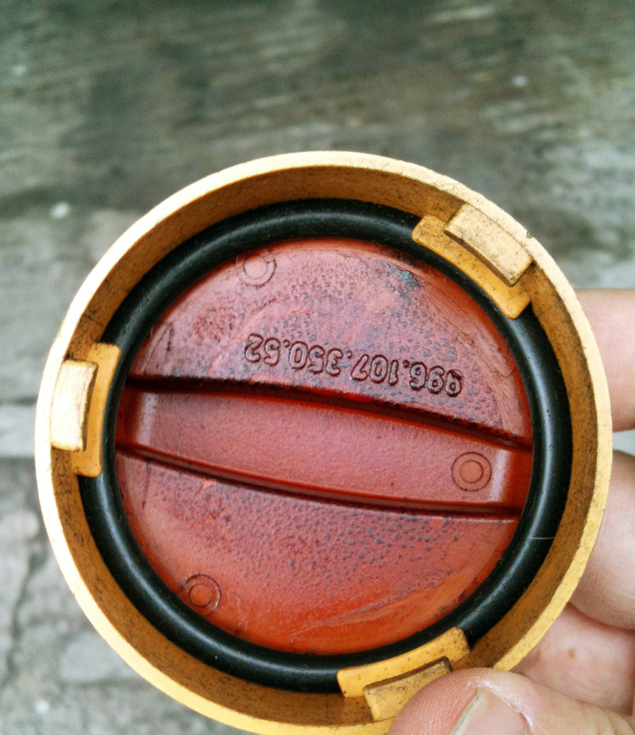

P.S. : According to one of the buyers' guild, it says the inner engine oil cap will tell how the engine has been, is this true? If so, here is a photo of mine. Besides, I have noticed on the 1st day of driving the car that after running for 1/2 hour, when I open the oil cap, there was very slight smoke coming out, is this normal?

The oil cap in the photo looks normal. The issue you are likely referring to is the Rear Main Seal, and/or Intermediate Shaft Seal. Common problem with these engines and you can find lots of info about that by searching this site, so I won't cover it again here, just search for RMS or IMS. The issue is repairable with a new design and the engine is not destroyed, you just need to get it repaired if it starts leaking or seeping. I would say that Porsche will not offer any help with any of these issues....especially on a car that is 12 years old.
A little smoke/vapor coming out of the oil cap after running is normal.
If you have no oil drips on your floor, you may have no issues with this car. You should stop worrying so much about it, and drive it and enjoy it. They are overall great and fun cars.

Your oil cap looks fine.
