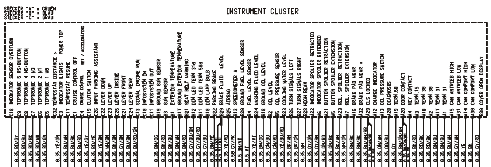

has anyone got the pin outs for the multiplugs on the facelift 996 instrument cluster.
ive got the same workshop manual as most probably everyone else and it only shows wiring up to 2000.
did the pin outs change on the later panels or were they the same and the cluster itself was just different. i dont want to start poking about with the loom until i know ive got the wires correct.
