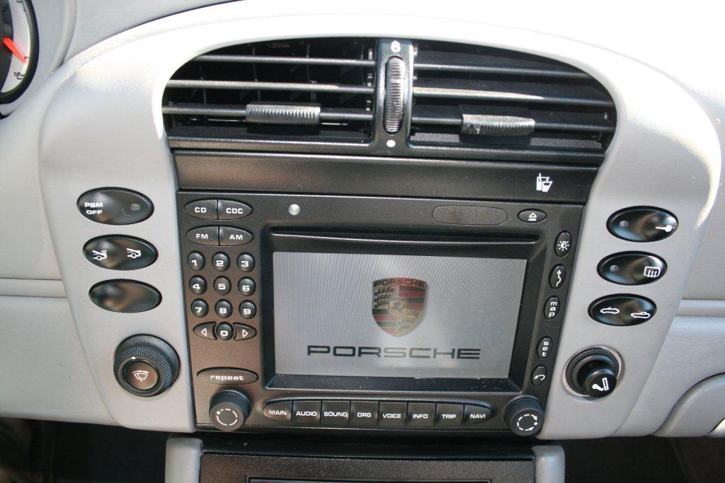

This may be a silly question but am hoping someone can shed some light... I have an '04 911 Turbo with the PCM / Nav / Bose system but the previous owner doesn't have the NAV discs. I was thinking about going with an aftermarket stereo as I did in my 986 S, however, that car only involved changing out a CDR-23, changer and stock amp. The turbo is a little bit more complicated from what I can tell because of the stability management (PSM). I see the head unit displays GPS, temperature, etc. data and don't know if replacing the head unit will have unforeseen ramifications - in particular with the PSM. I've seen posts where people have done it but have gone through shops for the change while I'm planning to be more hands-on with the project as dictated by lack of funds. I'll be sure to keep the MOST in place should anyone ever want to go back to stock but am just trying to avoid any unforeseen land mines before getting into the swap. Any advice is greatly appreciated!

Removed the PCM, stock amp and CD Changer and replaced with a Kenwood Nav unit, Kenwood Mono Amp and 8" Kenwood sub in the cabriolet's bassbox. Huge improvement in the sound, looks, functionality. Thanks again for clarifying the PCM question for me.
