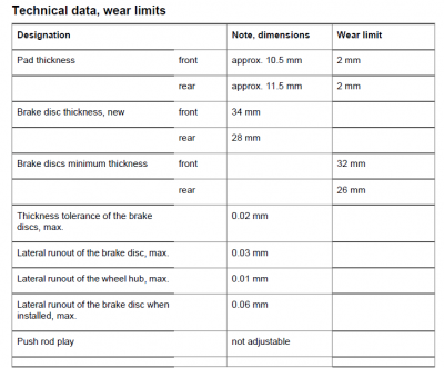

2. I'd like to change the rear brake-pads. Is there any way to check if I need to change the rotors as well? My car is at 85K.

I attached the instructions for the Particle Filter. If the rotors do not have grooves, are not warped, and have not been turned beyond minimum thickness, you do not need to replace them, You may want to scuff them with some abrasive (sand paper).
