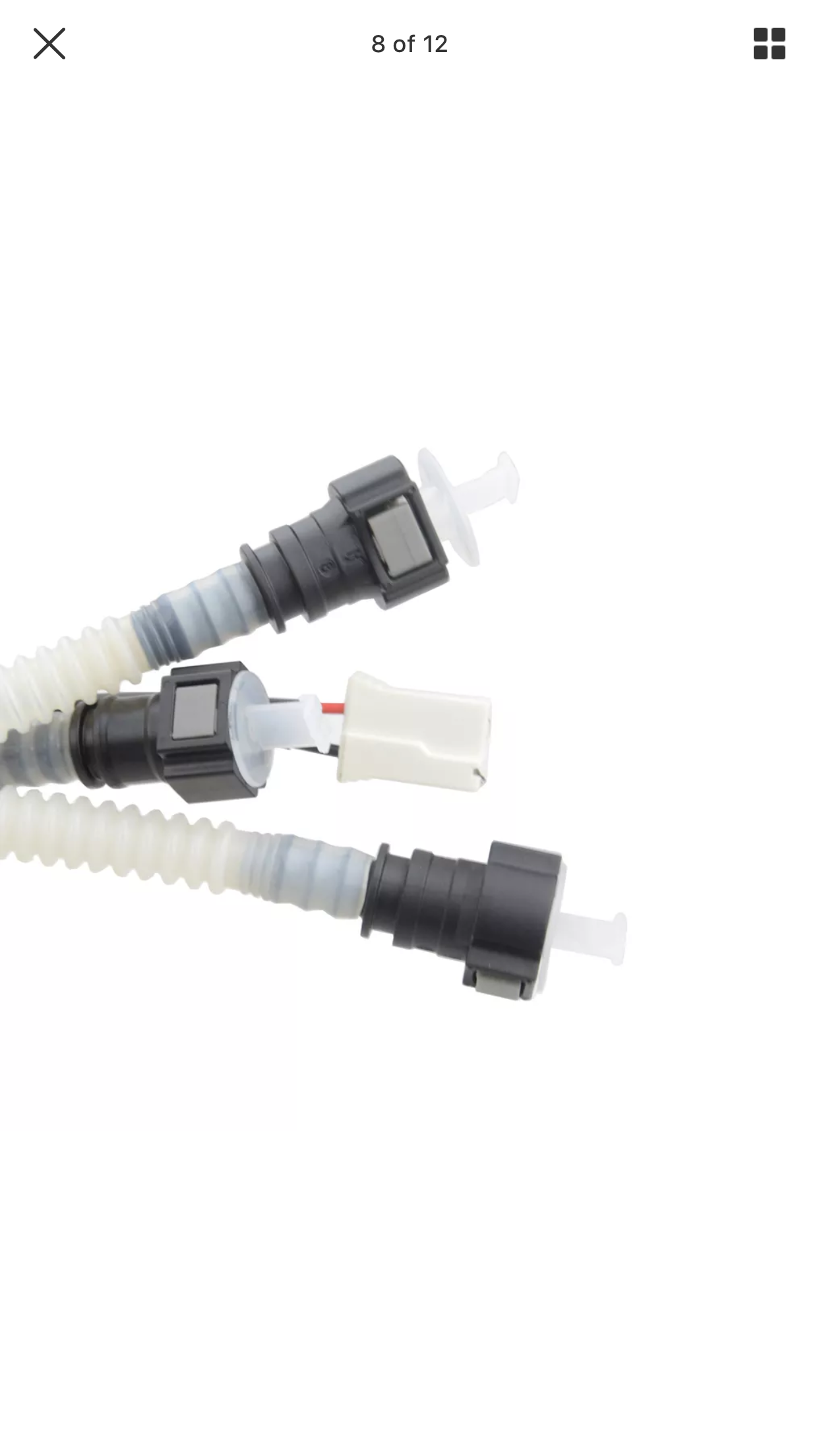

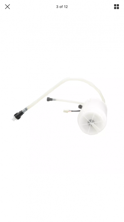

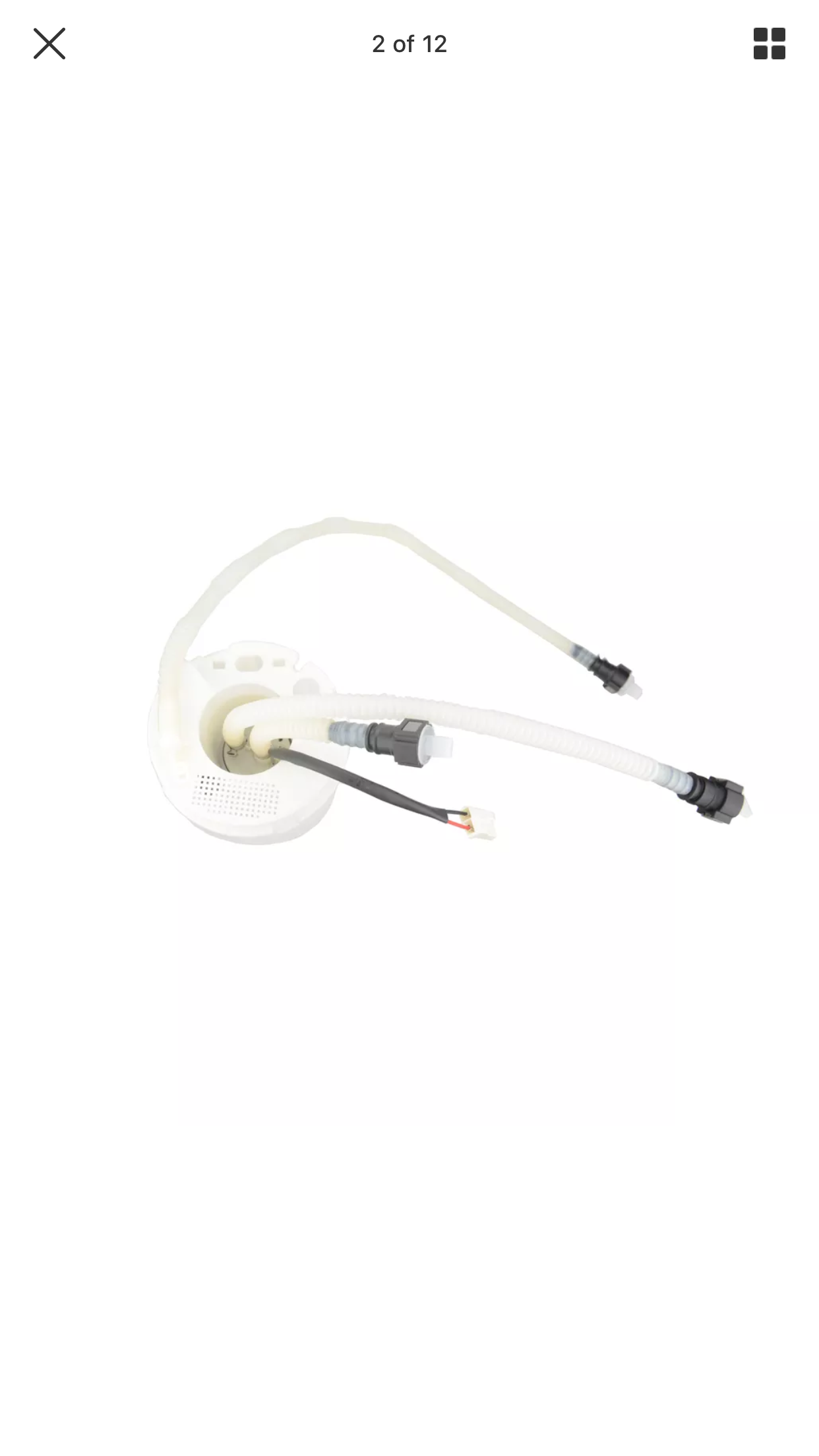

Hi all I see this is an old thread I'm hoping someone is still around I have the same problem left pump inoperable and read a Toureg one may work attaching pictures of the Toureg one any comments appreciated
