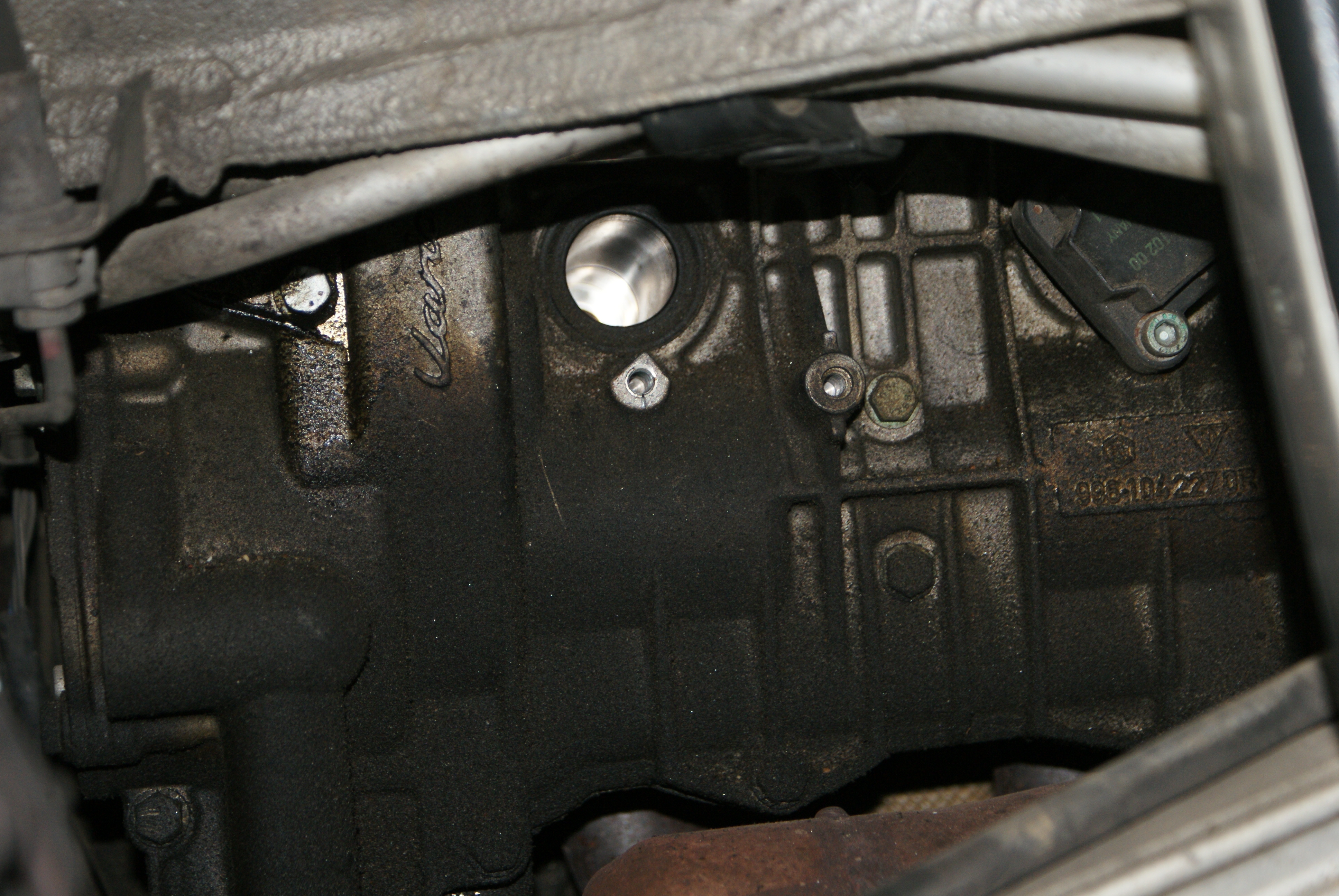

Once you put the top in the service position, you can get decent access to the top of the engine. You can then get a little more access through the engine cover on the front firewall of the engine compartment.
There is a product made by Simple Green called "Extreme Simple Green" which is excellent for engine cleaning. One of the really great things about this particular cleaner is that it is non-corrosive and will not etch metal or plastic parts. It also leaves no residue.
After spraying it on, you can use a toothbrush for heavy deposits and then rinse it off. If you are nervous about spraying water on the engine, you can wipe it off with a damp cloth instead. If you are going to spray water onto the engine, it's a good idea to cover or wrap the electrical connectors and components with plastic or cling wrap.
Take some before and after photos for everybody. We like to see clean engines! jump.gif
As you can see in the photo... no jack or stands are needed.
