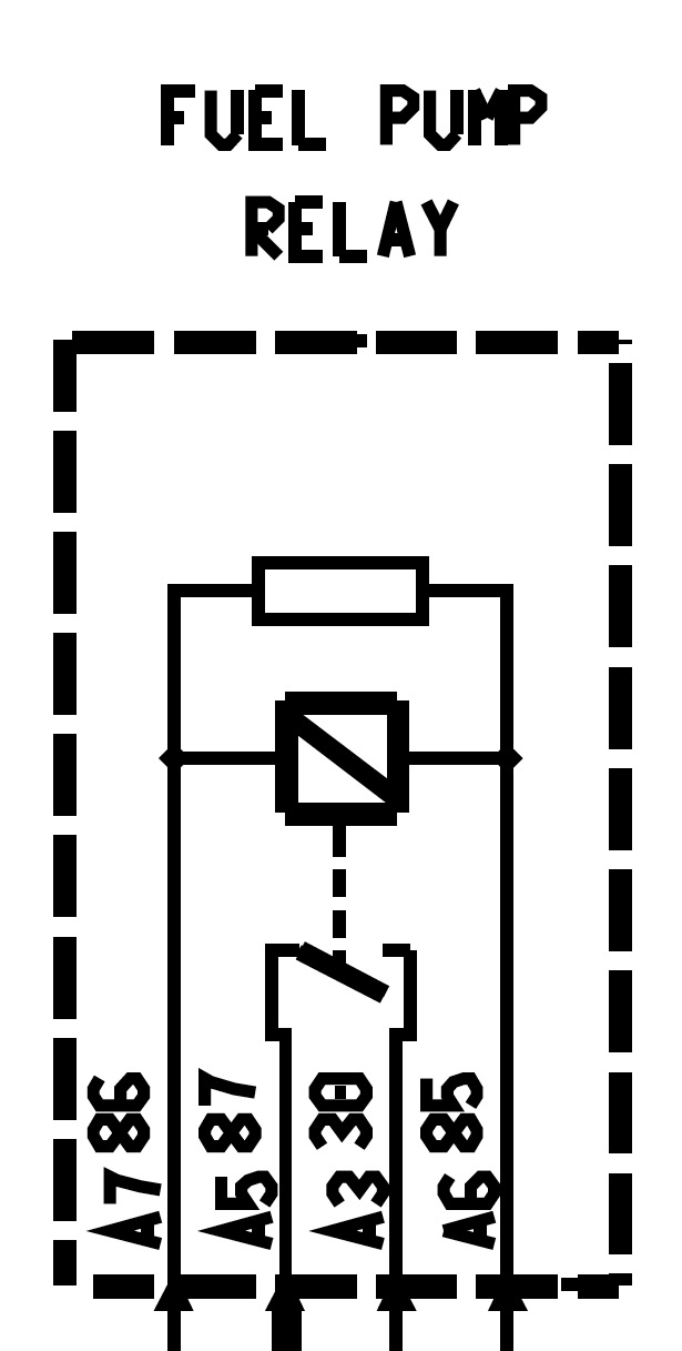

jpflip:
The terminals that you have circled look like number 38 and 87 in the diagram.
Thanks for posting the tool and procedure.
It is the German way to make the difference between the number O and the letter O in electric diagrams, terminal 38 does not exist on such relay, according DIN standards.

jpflip:
A blow up picture of the wiring diagram will show you a little difference between 0 and 8. It is important especially when you are ordering relays....
