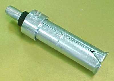

Hi - i just did my coils, plugs, tubes and o-rings on a 2000 996. Removing/replacing the tubes is a really simple job with the right tool. I purchase the factory recommended puller tool - from Kukko P/N: 21-4 (same as Hazel 788-30) - A$100 well spent. Instructions are in the repair manual at Group 15 46 19 - page 15-83. However instead of the two mounting bars, I used the nut on the puller to secure a ring spanner under a large washer and then levered the puller and tube out against a wood block against the engine. They all popped out with little to medium force. Prior to installation make sure you use the recommended lube on the o-rings. To install I used the handle end of a large screwdriver - that fitted snuggly on the end of the tube without getting stuck - to push them back in. Hope this helps.
edited to add photo of Kukko 21-4

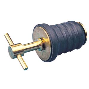

$100 for the Porsche tool that you might use once every 5 years or so is crazy. Go to your local marine supply store and get a transom plug like this for less than $5. Get the right size and they work just fine.

Can you post a photo of the Hazel p/n 788-30. I used the transom plug and it worked slick.

I went the $5.00 route had no problems changing tubes....

Thanks a bunch. Well documented procedure and love the creativity on the transom plug.

Completed spark plug replacement and tube o ring replacement with no issues. Used the transom plug and it was a little fussy but worked. Just need to rememeber to put it back in my friend's boat before he goes fishing.....
