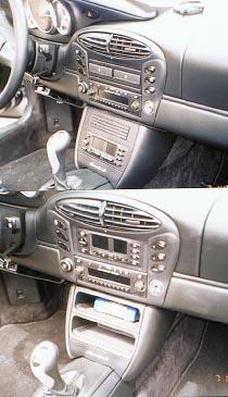

Found this pic of the unit mounted in the lower slot -

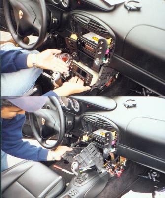

There is a 4 page instruction sheet from Porsche on how to do the retrofit. The retrofit kit has all the parts except for the a/c display trim piece for it's new location just above the shift. You need to buy it. It is not included in the kit because the trim you need could be in leather, wood, etc.
This is a before and after shot.
I came up with the word cupholderectomy almost 4 years ago when we removed the in-dash ones from a 2001.  Now you want to put them in. :P

You can do the retrofit now while you are waiting for the trim piece. You will be running the a/c display wiring harness down to the batwing. It is very long so there is no problem with it reaching. I suggest you remove the radio or at least pull it out a bit first, as the connectors for the harness are large and it is hard to get them past the back of the radio head.
The only trim piece Porsche has for the a/c display just above the batwing, like in the picture, is what I gave you.  Porsche does not sell a trim piece for where the cd holder is in the picture.
