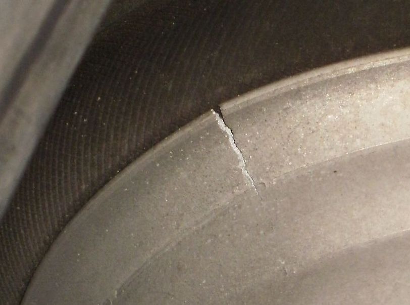

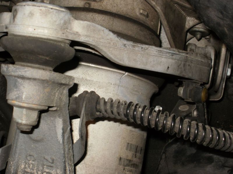

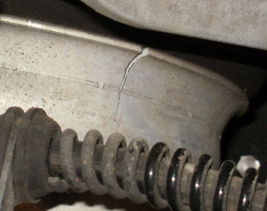

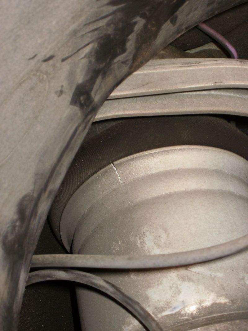

Hi I found 2 cracks on the drivers side front airsus housing. From what I understand this is a protective 'shell' but does not carry weight or hold pressure. Do I need to replace the shocks right away? Thanks in advance.
post-40239-0-34315000-1345879125_thumb.jpost-40239-0-98710100-1345879167_thumb.j
post-40239-0-72332000-1345879197_thumb.jpost-40239-0-32769200-1345879210_thumb.j
voodocat, what year and model is your Cayenne? It would be good to see some correlation between models and/or model years. Maybe only a year or two affected? I haven't heard of many problems on '05 and later Cayennes? Maybe they have an improved part?
