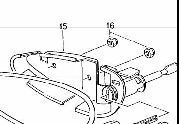

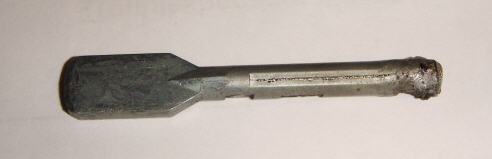

Since you have been using the key itself to lock and unlock the door for quite some time, it's probable that a small rod in the lock assembly has either broken apart or become disconnected.
You will have to remove the door panel to get access to the mechanism, but the difficult part is getting into the car to begin with.
