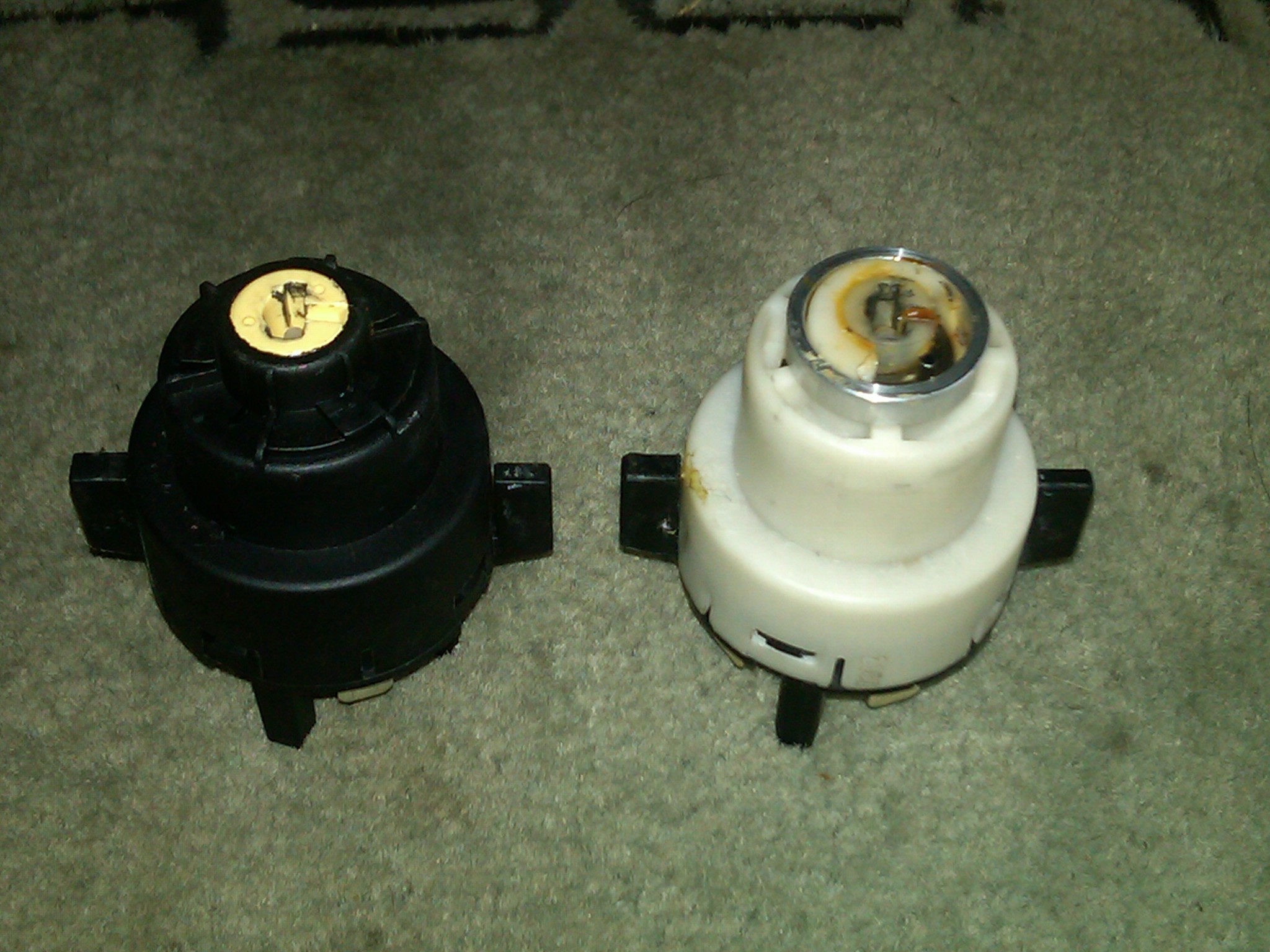

Ok got the screws out and removed the old component. It was cracked. Go figure. Now I put in the new one, and I think I did everything right, but no start. I'm pretty sure I got the key extension male to line up with the switch female. Went through with gentle pressure on the switch and gently turning the key, but then try to start and nothing. Everything else works. About ready to fire bomb this thing!!!! By the way, there was a silver ring around the old switch, and nothing like it on the new one. Old is to the right, new one to the left.
Any suggestions? Or since I have it in service mode now, would I be better off just to replace the whole ignition with the updated part?

Is it possible that I got a bad switch as a replacement?
I haven't done the full ignition replacement. I wonder how much work that is because replacing this faulty piece is getting old. In your picture, on the wide end which sits on the table, the three protruding plastic prongs have different shapes. One is square and the other two are round. When you marry these with the other part of the ignition, if you get these squares and rounds matched correctly, you can't get it in wrong. If you have to force it much, they are in the wrong holes. When they are in the right holes it should snug up and all the metal connecting tabs go in the proper slots.
I don't think you have the right part. The white one is a new design, and the black one is the original design. Not sure when they made the change but the older boxsters had the black switches originally, and Porsche's answer is to replace the rntire mechanical part of the switch with the new white part. I don't think the black switch fits correctly in the new design. I think you need the new white switch part to replace it.

I did the same thing few weeks back. Looks like you have the wrong part.

Thats strange as I ordered the part from Pelican, and it was listed for my year without upgraded ignition.The steel ring comes off, and it looks just like the new one. If that is in fact the wrong part, what part number should I be looking for?
If the electrical portion of your switch is white, I'm pretty sure your ignition switch has already been replaced once. So you would need to "new" switch portion.
Well, the part number 4A0905849 is on the white part with the Audi symbol next to it. So I've decided to swap out the whole thing. Picked up the part From Sunset for $130, and will work on it tomorrow after I get back from fishing. I'll let you all know how it goes. Thanks for the advice/input.
