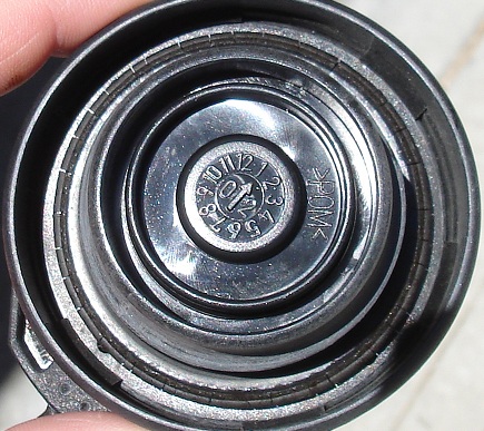

Have you tested your AOS? While the car is running and warmed-up remove the oil fill cap... Is the cap difficult to remove? Does the idle drop and motor almost die? If so, the AOS is bad. Also look at your gas cap seal, does it have cracks like the one in this picture?
Hi,
Just checked the oil fill cap. It's easy to remove when the car was running and warmed-up. When it's removed, the idle didn't drop and the motor was running fine.
The gas cap was replaced not long ago and it's in good condition.
What else should I check? Thanks.
Steve

It's too bad that you spent money needlessly replacing the items you replaced but they are the things that are commonly recommended to replace when emission codes come up. Have you done a search on this site by entering the code because I believe you will find a lot of information regarding what this code indicates? My recommendation is that you take the car to a mechanic who understands the Porsche diagnostic tree and has the equipment to track down the problem otherwise you will continue to "shotgun" replace parts that may not need to be replaced. I'm speaking from the experience of also needlessly spending money on parts replacement involving this code and others like it. After spending $700 the problem turned out to be a disconnected twenty five cent vacuum hose so please save yourself some grief and money and let someone who knows what they are doing fix it.
