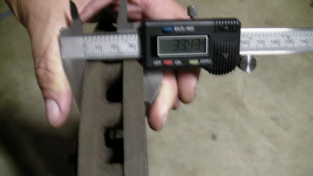

I just need to know how I measure the rotors. From where to where?

Go to a place like harbor freight, sears, or even home depot, and buy a set of calipers:
take the wheels off the car to expose the caliper, then measure the thickness in the shiny smooth section of the rotor. There will be a small lip near the outer edge of the rotor that will be thicker - don't measure there. Check the thickness compared to the minimums Loren posted (26 mm front and 22 mm rear).
Better to use a micrometer (IMHO) - since you are looking for the thinnest portion of the disc.
Problem with using calipers is that you will not get to the thinnest areas - like where a rock has ground a groove.

There's a tiny portion in the edge that is not reach by the pads, this can lead to inaccuracy. But a wide range in the safe parameters can rule it out.
