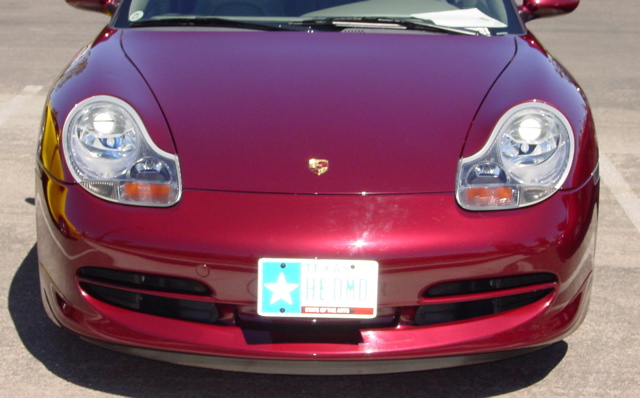

I am going to replace my lip (996 505 98600) on the GT3 spoiler with the supercup lip (see picture) and was in need on the part number.
Also, any pdf's or pics of one in use? The pic I attached is the best I could find (not that good).

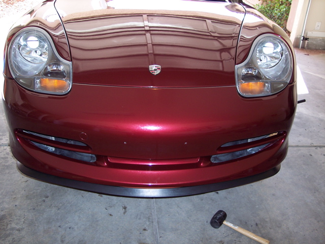

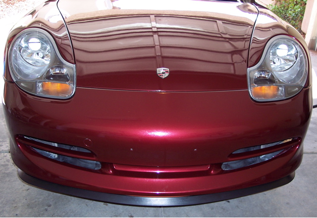

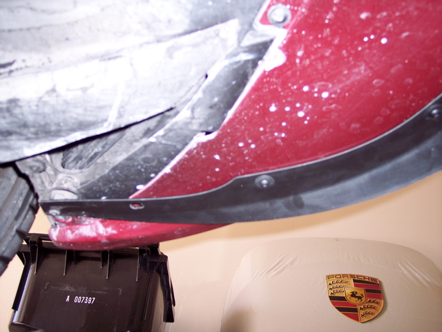

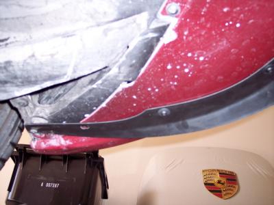

OK, so I finally got the lip installed. 1000X better aesthetically than the mk1 lip. I have attached some pics of the final result with the mk2 lip (supercup lip).

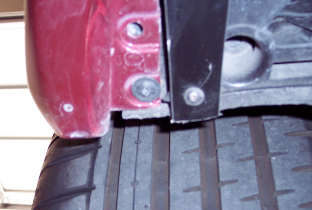

FYI....it is NOT a direct fit based on hole alignment except for the middle hole which is perfect so you can line it up perfectly centered. What I did was attach the lip to the GT3 bumper using the single hole that lines up (middle one) and held the rest of the lip on with painters tape.
Then I drilled holes into the GT3 bumper using the new lip as a guide utilizing the predrilled holes in the lip. I also used the screw holding on the brake duct and the end of each side of the lip for added stability. One last thing....I have to cut off about 1 inch after install was complete where it went past the bumper into the wheel well opening.
Total time from start to finish was under 1 hour.

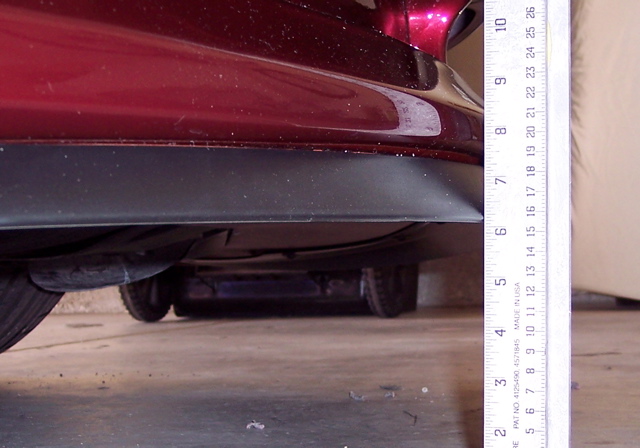

:drive: 1.5" gotcha
probably not a good idea for me right now with my ride height in the weeds @ 5.5" adding the lip would put me at 4" (yikkes) - probably just go through them like popcorn
<edit> this is Raised by the way from when i got it by 0.5" as i was having some shock travel issues - hitting the bumpstops on the pss-9's </edit>

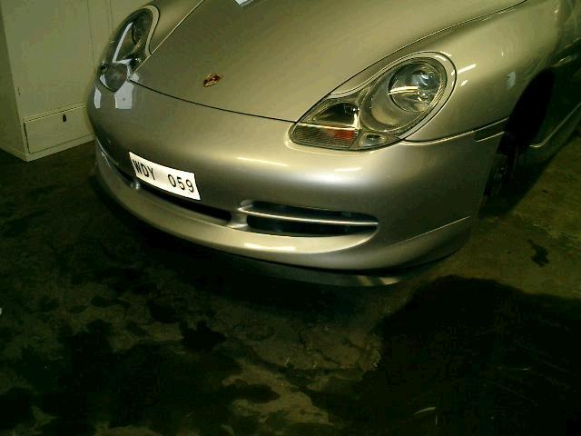

I lost my front lip in Bordeaux last week. Hit something in the road and it clean snapped in half and was left on the road.
Made the 2800 mile trip to Spain and back in one piece though ;)
