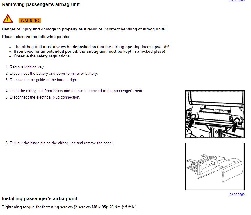

JFP makes very valid safety points... I would add that when storing the removed air bag... do not keep it face down or under something... this way if it were to go off it wont launch itself or your workbench.. (they're pretty **** powerful)
Heres a screen cap of Porsches safety/removal instructions...
Cheers!

Also I assume that in the caution note to have airbag opening facing up - the opening they're talking about is the "opening face" that faces the passenger in the installed in the car ?
I've also read to disconnect the battery and wait at least 1 minute before removing the airbag. Was planning much longer but just want to confirm.
