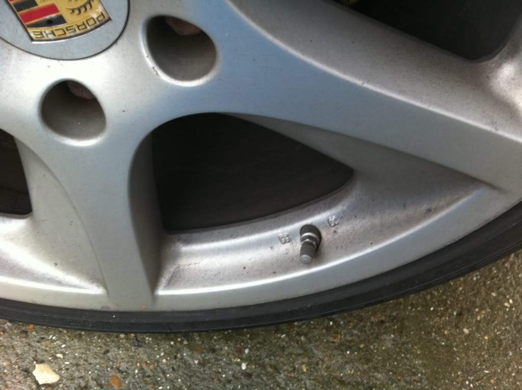

This is a pic of my wheel and the valve - does that look like it has sensors?
Thanks mudman - i'll try some tyre shops
Yes, that looks like a sensor, as you can clearly see the locking/sealing nut on the stem. Just about every type of shop has TPM system tools these days, particularly tire shops. Many will test for little or even no charge as replacing just one of the sensors is going to generate a lot of revenue for them......
