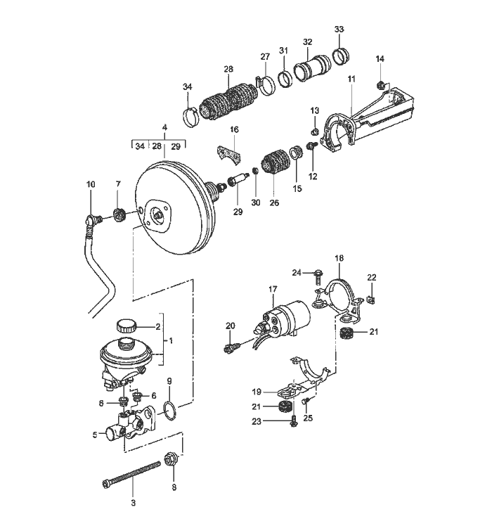

Need to know what that brake booster looks like and if I've got one!
Here is a diagram of what the brake booster looks like on your car...It's part #4 and looks like a big black flattened metal drum:
post-6627-0-03561600-1341951082_thumb.gi
On your UK car, it's on the right side, in the front trunk compartment, sort of in line with where your brake pedal is, ahead of part #11, which is a heavy aluminum bracket.
