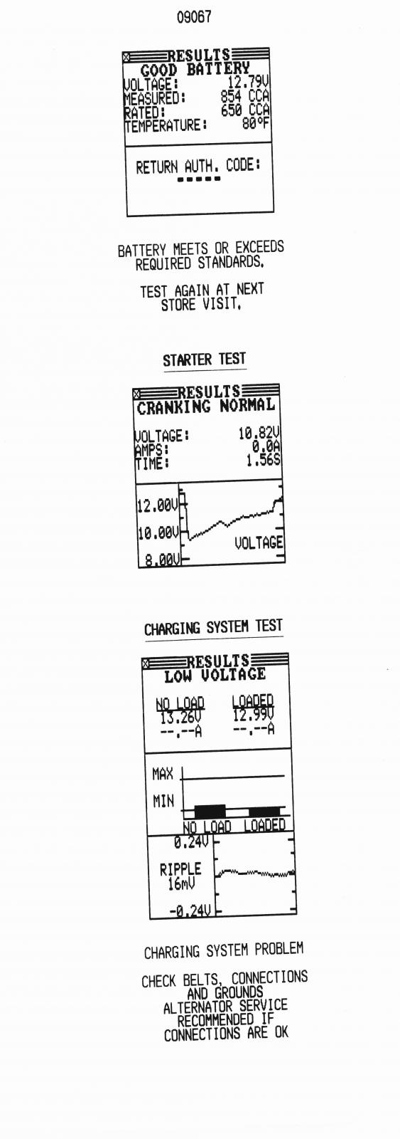

post-42763-0-71442300-1345324023_thumb.j
Loren - it looks like the alternator/voltage regulator is only maintaining the battery at a little over 12 volts.
Bench tested the original battery and it was good.
Tested the battery and charging system in car: Battery good, starter good and alternator low voltage. We tested at the Carquest store and in the air after jumping out of an airplane.
Should I put faith in their generic tester?
I hope its the belt and not the $1600 alternator.
If this condition of the charging system isn't acceptable, it will have to be repaired, and then I've still got the alarm system issues, unless they are resolved by maintaining a higher minimum voltage?
Mike
