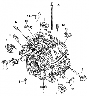

Have you checked to if the engine compartment sensor has fallen out of it's holder and it laying on hot engine parts?
Usually when that happens the engine compartment cooling fan runs all the time once the car is warm.
Item 12 below - between the intake ports on the right side.

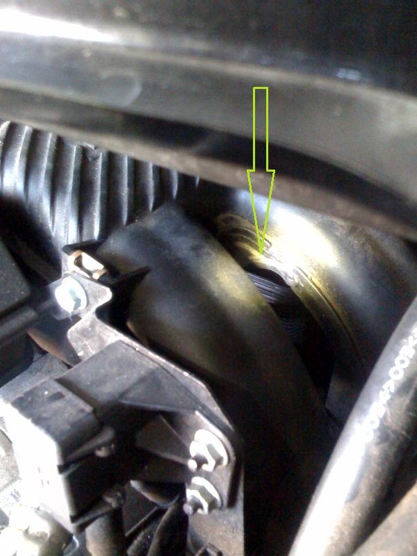

Loren I took this pic just a minute ago. Here it shows that there's no harness locked into the C-clamp OR rubber grommet. Where item 12 is suppose to be which it isn't. My car is a 996.1 1999.
Edited by J_STATUS
As I said it can fall out of it's holder and then lay on the engine. You need to feel around and find it - then put it back in the holder.

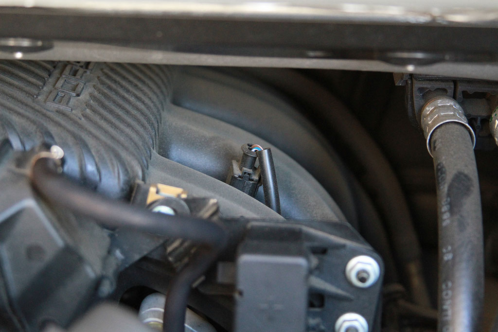

Here is mine (what a dusty engine!)... MY1999 C2
post-1-0-48004000-1348783862_thumb.jpg post-1-0-40250200-1348783865_thumb.jpg
Found it! So I temporarily placed it by the a/c line away from the engine. As I found out that the rubber grommet that will hold it is missing. So I need to go to Porsche Walnut Creek to order the rubber grommet. Once I get it I will put the sensor back where it's suppose to be.
I drove about 30 mins so far so good. No more blinking, but I'm waiting for tonight to drive this longer (30 miles) and see if it really doesn't blink anymore.
Thanks again!
