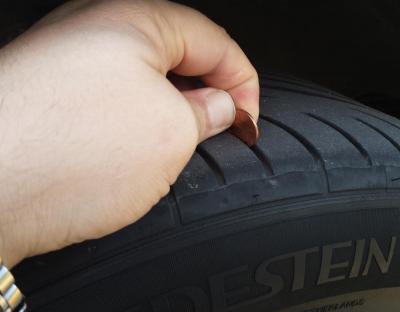

Including pics of what the tread looked like at replace time (compare with pics from first post - new).
Thanks for reading. Now, maybe those who are looking for tires will have a decent info to try to compare to.
I will post my reviews on the next tire as well, to add to the pool of info for Cayenne users (maybe other SUVs too).
