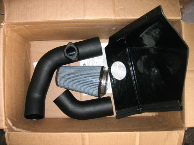

Dyno Report : Evo Highflow Intake Kit on Boxster S

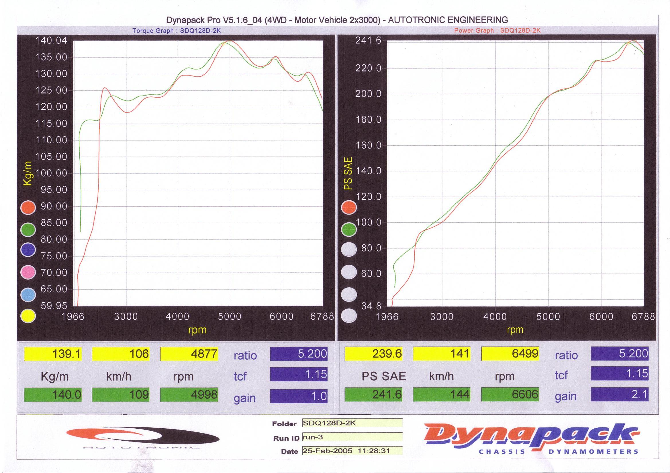

Results as follow :
Horsepower (at the wheels)
Base run with Dansk headers/Dansk Sports Cat/Dansk Sports Muffler : 239.6bhp @ 6,499rpm
Run with addon Evo Highflow Intake Kit : 241.6rpm @ 6,606rpm
Gain : 2bhp at about 6,500rpm
Torque (at the wheels)
Base run with Dansk headers/Dansk Sports Cat/Dansk Sports Muffler : 139.1kg/m @ 4,877rpm
Run with addon Evo Highflow Intake : 140kg/m @ 4,998rpm
Gain : 1kg/m at about 4,900rpm
The fuel used for all dyno is 100 Octane as this is available from most pumps locally. The dyno graph is attached. Red is the run with the intake.

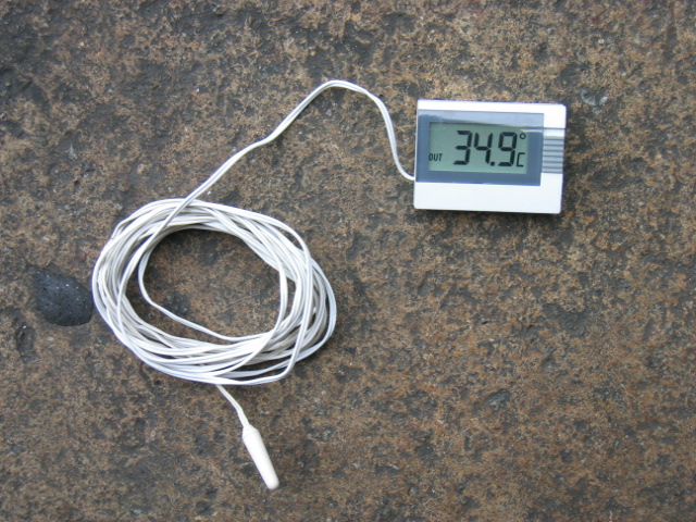

An air temp probe was installed before/after the change. I'm using deg Celsius over here so resulted in the double digit for deg Fahrenheit after conversion. So it's not that I'm using a super accurate temp sensor A picture of the sensor is attached for reference. Cost me about US$15. The following were noted :

- bhp was down everywhere except about 2,000rpm and 6,500rpm
- bhp drop is significant at 3,000rpm
- torque was down bet 2,500 to 4,800rpm and 6,100 to 6,400rpm
- Drop in torque is significant at 3,000rpm, about 5kg/m

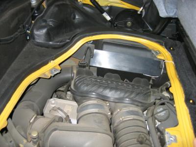

The stock air box is a real PITA to remove. The intake manifold needs to be loosened and even then, pulling the airbox out was no easy task still.
Needless to say, I'm unhappy with the overall results. I think the car is still somewhat better compared to a completely stock one but for the money spent till now, the past 2 mods (muffler & intake) have yielded negative results.
