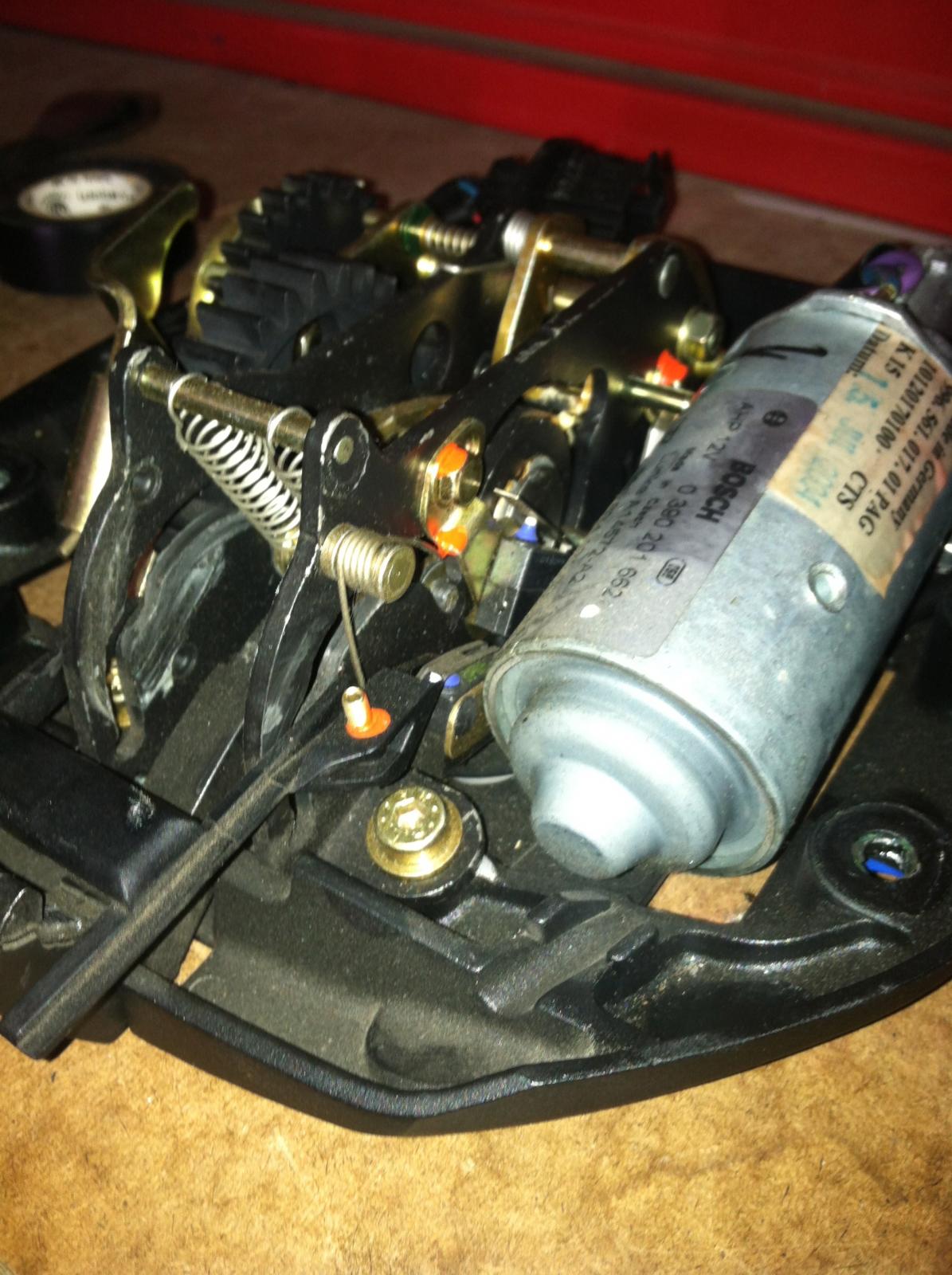

My top is stuck in the closed (up) position. My local Porsche mechanic told me to take off the locking mechanism on the roof and check the micro switch on the windshield frame. That switch seems to work, however I think I have a bad micro switch on the locking mechanism itself. There are 3 micro switches next to the locking arm (Bosch) motor cylinder. I verfied one of them works because when I depressed it the top would rotate back and forth. But I think there is a micro switch that allows the locking arm to operate and that seems bad because the locking arm isn't moving at all.

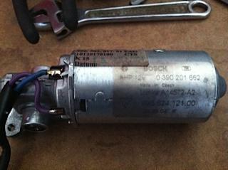

I followed the owners manual to close the top so I can take it to the shop. When I tried to manually open the locking arm in accordance with the proceedure, the gear wheel wouldn't move. I took apart the locking mechanism and found that the motor is binding. I removed the motor and the arm rotates fine. Therefore I wonder if I need to order a new motor (pictured)?

After taking this to the shop and explaining that the locking arm mechanism was binding, the mechanic proceded to take the better part of a day to figure out that I needed a new locking mechanism. The car isn't fixed, yet they left a message that the total charge is $400+ for shop time (I guess). I haven't had a chance to talk to them, but does this seem ridiculous? I know these cars aren't cheap to fix, but I went in there and told the guy exactly what I thought was wrong. Can someone be the voice of reason here?

Getting a 3 minute cryptic email from the repair shop receptionist is to be taken with a grain of salt. She got the details AND the total charge wrong. The mechanic ran through a laundry list of items to come to the conclusion that a new latch is needed. He thinks it's a failed microswitch in the mechanism itself that was continuously returning a fault code. My regret is that I didn't try to tinker with it a bit more to see if I could've figured it out. Regardless, the top needs to be recalibrated anyway once the new latch is installed.
