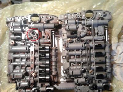

I'm on the way to change valve body. I want to order it, but they said to me that they are two versions with or without 2 pressure switches (sensors).
I there any option to know this without opening the transmission?
I really don't want to be without car 14 days because of that.
I attach picture to know about what I'm talking.

You may need to run the the car's VIN past a good parts person at the dealership to check which type is in the vehicle.
Find a parts dealer/OPC in your area that can enter your VIN into their PET.
Your VIN in the Porsche PET system will show the parts for your car.
I could do this but they changed the procedure last year and now you only have access to cars in your locale (i.e. for me US and Canada)... sorry
Thank you for fast answer.
I'll try to find someone, but these will really be difficult. I already asking something, but they want to have car one day in repair shop to figure out which valve body is.... With the oder words they want to do all the repair, but I don't want to tell what outstanding price they give me... So I want to do repair myself. Really sucks that I didn't know that when I was changing oil and end filter, I could easly see it. :(
If can anyone help me, here is the VIN. : WP1ZZZ9PZ4LA47569
Thank you
Schaltgerat fur ID9L (V8 Cayenne) >> LA 81706 955.325.03900 i think this would be the right part # for your car.
Thank you a lot for help!
So looks like I have valve body WITH those pressure switches.
Now, when I have part number I do some more exploring and looks like that those switches were present till 7-04.
Your 2004 Cayenne S has the two hydraulic pressure switches fitted on the transmission valve body.
From the PET parts list, the part number of the valve body you require is 955.325.03910.
(955.325.03900 is for turbo Cayenne)
www.sonnenporscheoemparts.com has your part for USD $1015.

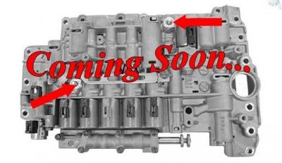

I got new OEM valve body 95532503910, but it is different than mine!Please can you look at the picture and tell me what these difference between old and new body is? On NEW one is one hole more to plug or put something in...
Now I don't know what to do.
Please help
post-84890-0-65027900-1357815790_thumb.j
Well, I install new valve body, and for now it look everything ok. But I'm still curious, for what that additional port is.
I'll report back when I'll do some more driving.
Just had the exact same issue today on my CTT. It turns out that the additional opening and hole is for a temp sensor for newer Cayennes. No impact for our older units.
Great to know! I was really scared, that I bought wrong unit.
