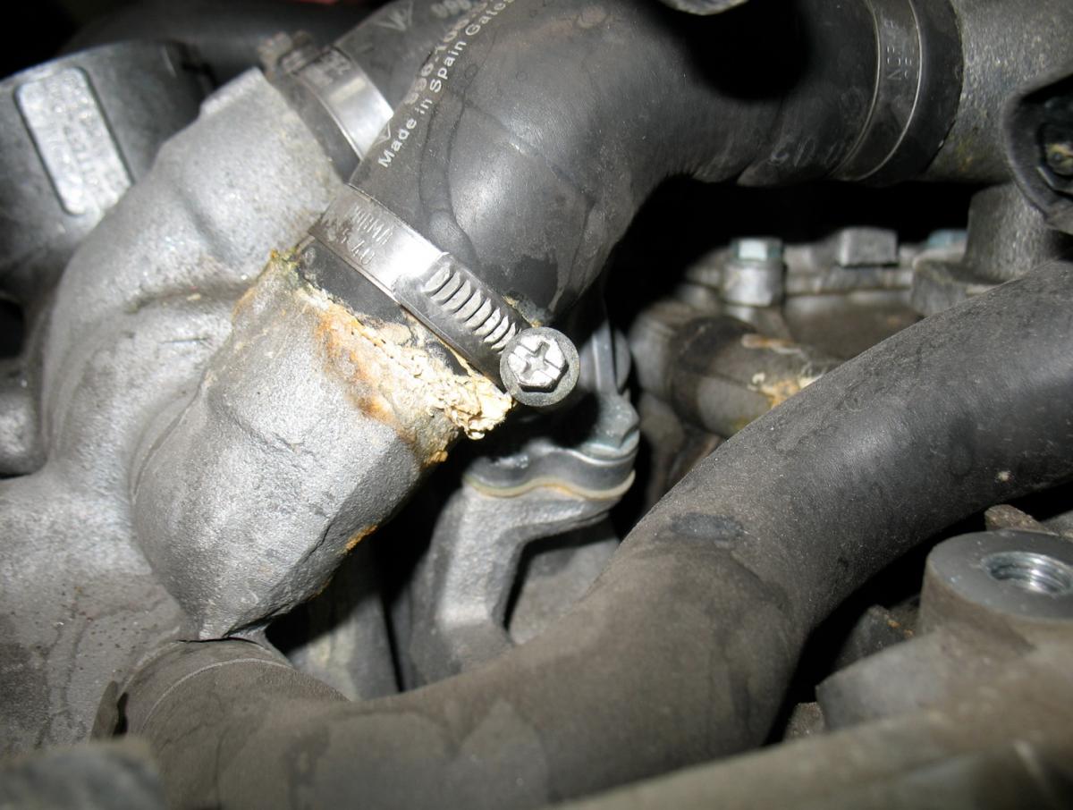

For a long time I had coolant smell and did not see any drop on the floor but a very small quantity was lost... I also did a pressure check and it was almost completely tight but a very small lost of pressure ( 1 pound for 20 minutes) that I attribute to the tool I was using. One day, before storage for winter, decided to do a very deep inspection and found a very small leak (white powder, dry coolant) after removing the air box and the intake. It was one of the coolant pipes on the water pump housing. Very hard to see, because of limited space and the pipe did not pop out because also of limited space.... And the fluid was trapped on top of the engine and eventually evaporate.
Believe it or not even after all this work I still got, sometimes, coolant smell. I feel paranoid about it the first time and did some other inspections but did not found anything. I guess we can consider this being normal on TT's. I also replace the expansion tank cap with the latest model, was 99610644701 and now 99610644704 but the smell is still there....
post-29683-0-96219900-1358077486_thumb.j
post-29683-0-72419700-1358077498_thumb.j
