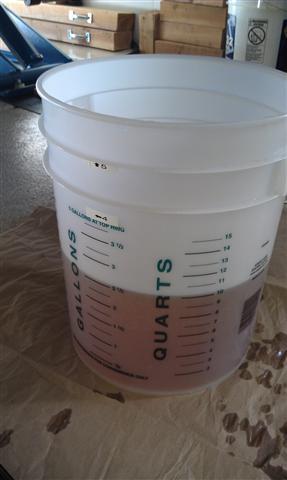

Hi guys,Just want to share with you I've found a simple way to drain all the 6 gal coolant out. I've looked at other DIYs and even the factory procedures but they all involve disconnecting coolant hoses that are under the car, which requires removing the underside panels. I'm too lazy so I studied the coolant diagrams and came up with a much simpler way.The total capacity is ~6 gal and you will drain ALL of it if you follow the steps below. Real simple.1) Remove the coolant reservoir cap and open the coolant drain plug at the bottom of the engine (SOP) and out come ~2.5 gal - all the coolant trapped in the engine block. Now put back and tighten the drain plug to seal the system.

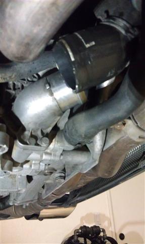

2) Put a 5gal bucket under the big hose connected to the thermostat. This hose is the coolant return hose from the radiators in the front. Disconnect the hose and out come ~0.5 gal. Now this is the fun part. Introduce compressed air to the coolant reservoir neck (a few PSI will do. DO NOT EXCEED 10 PSI. I used a simple rubber gasket to seal it). Be prepared, 2.5gal will gush out with force from the big hose - Congrats, you just drained all the coolant trapped in the front radiators! Basically the air goes into the radiators via the vent hoses and forces the water out from the big return hose.

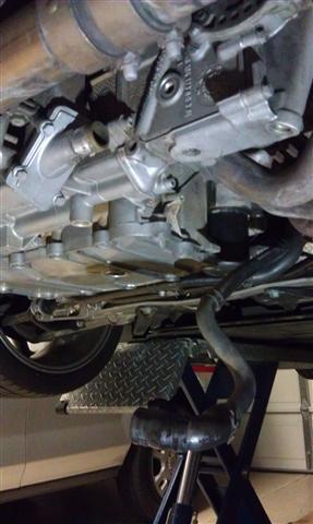

3) After steps 1 and 2, you've already drained 5.5gal (>90%) so you can stop here if you're lazy. For the perfectionists, of course we need to track down that remaning 0.5gal. Where the heck is it????You guessed it.....it's trapped in the heater core!! There's no valve. Forget about turning ON the heat when draining, etc. The coolant just recirculates the heater core whenever the engine is running. Now go disconnect the heater core coolant supply line from the engine and remove the two bolts holding the hard metal line so you can tilt down the hose like below. Remove the drain plug again and introduce compressed air at the hose side. 0.5gal will gush out from the drain plug and from the metal flange where the hose is connected to. Note this is the ONLY way to drain the heater core because the IN/OUT hoses connected to the heater core are at the top of the core. You can disconnect hoses all day long. Without force, the coolant will just sit at the core.Now go reconnect the two hoses and tighten the drain plug and you're done jumper.gifSo in summary, the engine holds 2.5gal, the radiators and hoses under the car hold 3gal, and the heater core holds 0.5gal. There's your 6gal smile.gifI used the cable operated hose clamp tool and a pick to break the surface between the hose and the metal part. Took me at most 5 minutes to disconnect each hose, if that. i think with practice, you can finish the above within 1/2hr. Note you need the uview vacuum tool to refill now that you've replaced all the coolant with air.
