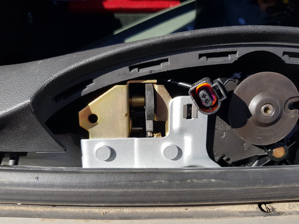

I fixed the problem by removing connector on the left hand side of the latch mechanism.
In order to reach it you need to take of the top plastic cover, and partially pray out big side plastic cover (so you can reach down and unplug this plug).
Unplugged connector is moved out on the right side, just for photographing purposes. (I put it back down after I took a shot and make sure that there is no window open alarm on my dash).
Cheers
