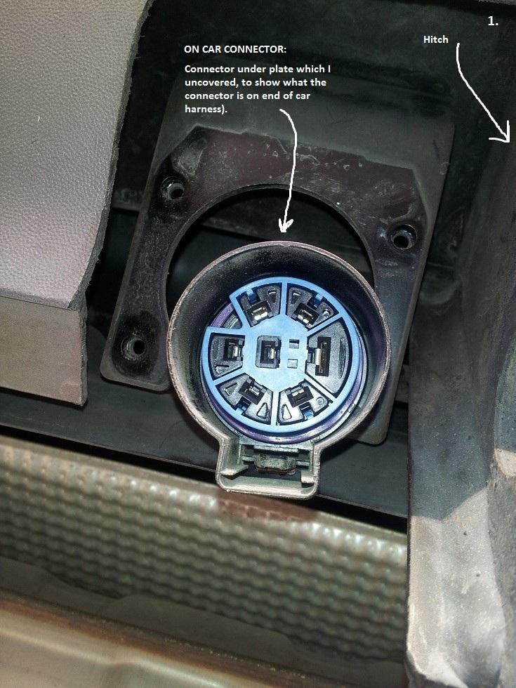

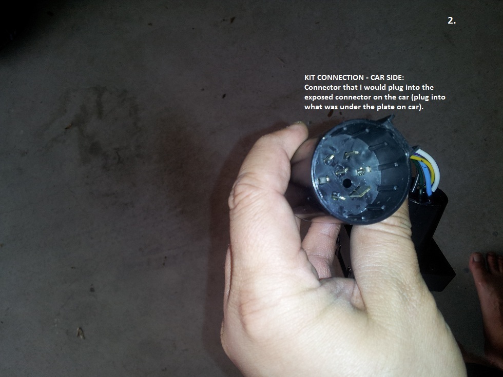

Unscrewed the little plate covering the wiring connector on the car.... and saw what I show in PIC 1.
So here are my questions:
1. Does the car come with harness that already has ability for brake control?
2. Is there anything else I would have to buy to gain the brake control capability if I needed to have it, with this harness/setup?
3. If I only wanted to use the hitch to tow trailer with straight 4 connector, do I still need to buy a kit that used brake control, or just any kit that plugs into this connector in pic, that translates into 4 straight connector?

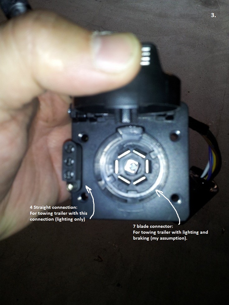

PIC 2 shows what I just purchased. It is a connector that is supposed to plug into the 7 blade connector I exposed, and on the other side - PIC 3 - has a 7 blad connection (assuming to trailer which includes brake control, lighting, etc), as well as a connection to a 4 straight connector for a trailer with this connection.
4. Will that setup work on my car? Do not want to screw anything up here...the package does not have Porsche cayenne listed at all, but the connectors on the car side seem to line up exactly, as the ones from the harness under the plate that I exposed.

The standard 7 pin connector is universal, so buying one that isn't PORSCHE is fine.....no issues there.
No for brake controller.....the caynne does NOT have an installed brake controller. However it is wired for one. If you pop the driver side knee panel off, you will see a connector (4 pin i believe). You can install any aftermarket controller there.
If you don't need the brakes, you can just use a standard 7 pin RV to 4 pin connector adapter....or even just plug in the 7 pin without trailer brakes....
I typically am towing bobcats and whatnot, so they are right at the weight were i would want a trailer brake.....but i have towed without it and while you can certainly feel the weight, the CTTs have plenty of brake power to allow for save towing.

So I bought the Hopkins 7 blade connector that also has a 4 straight connector on side as pictured above.
When I hooked up to the trailer, I observed:
- left directional works fine
- right directional works fine
- stop lights work fine
- tail lights (ones that are supposed to go on once you turn the headlights on) are NOT on.
Trying to figure out what the issue is. Bought one of them 4 straight testers, plugged in and the only led that is not on is the tail lights one. The others are on when plugged into the hitch connector.
So what could it be? Is the connector I bought not the right one for the CTT? I thought they were universal in a way that if they plug in, they will work. Connection from car harness to the rear of the connector I bought seemed to be identical. Plugged right in.
Thanks for help in advance.

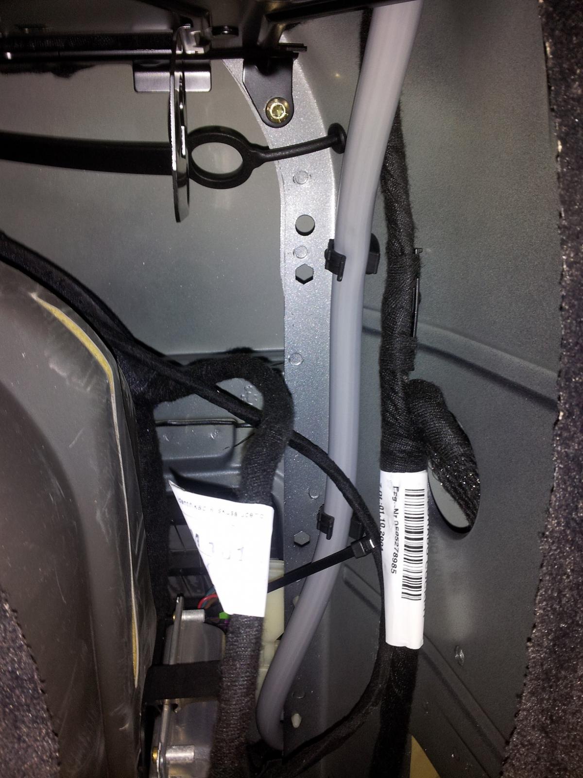

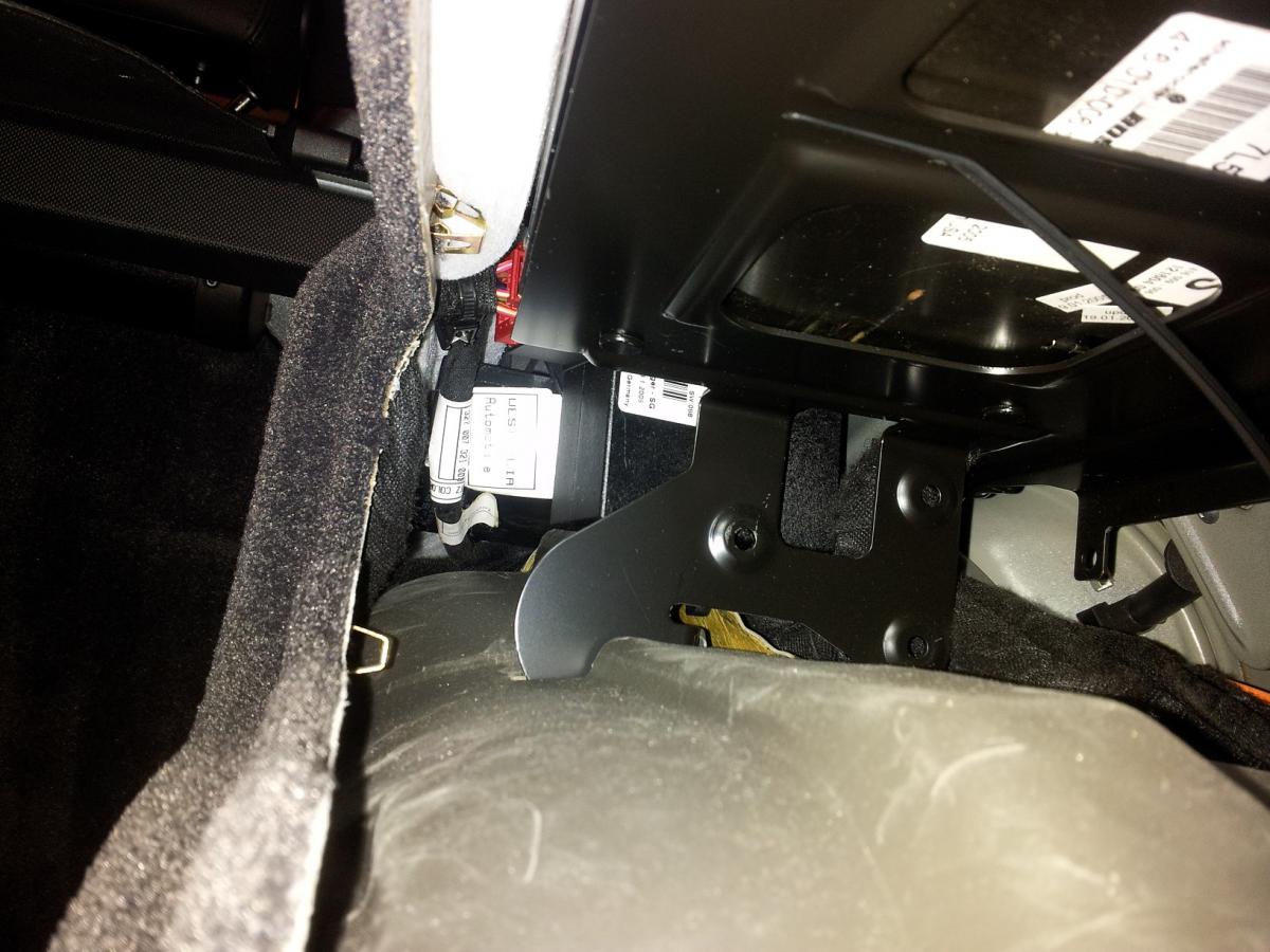

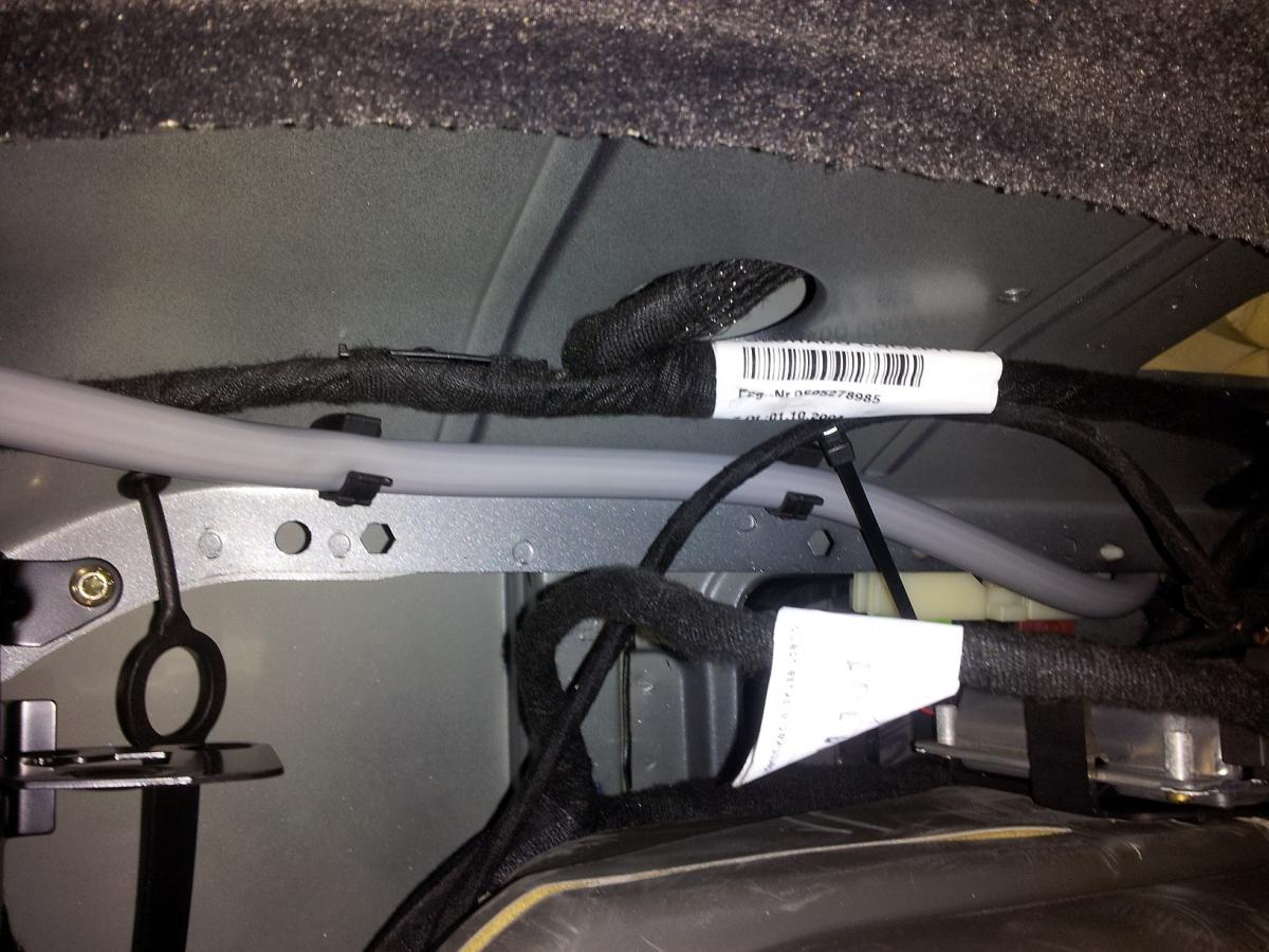

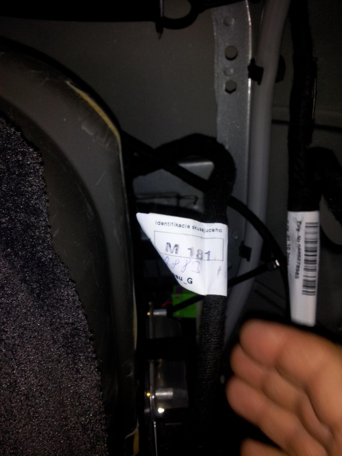

the bottom picture....the module would normally be above that.....basically right under the "shelf" that is formed below the rear window....if you pull the side carpet away from the wheel well, there might be a loose plug basically in the center between the carpet and wheel well.
If the plug is there then you don't have a control module.....if it isn't there, then it means the module is already hooked up.
