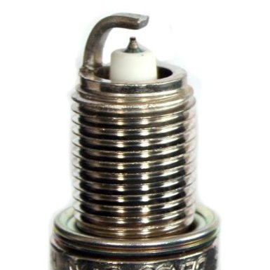

Anyway, when I ordered parts I thought I would try some Denso iridium plugs which Rock Auto lists as "one of our most popular parts", but I see now that the electrode configuration is completely different to the OEM plugs. They are the conventional type with a single ground electrode whereas the OEM ones have 4 ground electrodes. I guess they will probably work but I am reluctant to use them. Any experiences or comments anyone?

We have used them quite a bit, particularly on turbo cars that are hard on plugs and ***** to change out. Iridium's have a single side electrode and a very small diameter center electrode:post-18-0-84365400-1368992996.jpgThe Denso plugs work extremely well, and last a long time.
