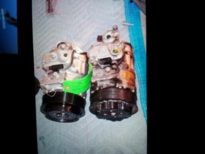

Both compressors are same. Lines same location, mount holes in exact same place too. Only diff us the two wires coming out of the ac unit. Old one has both wires going into connector. New one has Black wire going to ac.compressor chassis, the red going into connector. The new ac unit connector is also slightly different. I plan to transplant connector from old one. Any comments?
post-79141-0-79683600-1372862632_thumb.j
It sounds like that is not the correct compressor, which should be a direct drop in replacement.
confirmed with store and from online resources, get this compressor for my make/model/engine size. 05CTT 4.5L turbo.
They are identical in mold, all lines fit just fine, the only diff is the connector on new one has black line grounded at ac compressor chassis, and red line goes into conector, whereas on old one, black and red lines on compressor go into a connector. Connector on new one is slightly different (same shape). Can plug it in, but the red prong inside connector looks thinner and there is no black prong (since gounded at chassis of ac compressor).
SO my plan: remove connector from old ac compressor, fit to new compressor so that connection to car is identical.
Assuming compressor is for the car, do you see this a logical step? Researched and since this connection activates/deactivates compressor, then it should all fit fine.
Lemme know if you can. Putting things back together. That drive belt it a biach to do (putting in a new one anyway).
I would not be modifying anything to try and make it work. Like I said, the compressor should be a drop in, plug and play replacement; with absolutely no modifications. We do this all the time, the supplier should have given you the correct unit. If you start modifying it, and it still does not work correctly, I rather doubt those that sold it to you will take it back.
The DENSO part No for your car is DPC28010
If I google 60-01801 NC I am taken to the web page of discountacparts.com for Panamera 4.8L 2010-2012 which has a DENSO part number DPC28014 which clearly a different DENSO part number from the one which you require.
If now look up Porsche Cayenne 4.5 liter on the same site I again come to their ID no. 60-01801 NC. Click on the thumbnail to obtain a larger view and you get a reasonably detailed view of the compressor with this written underneath it
This is an exact* picture of your part. We do not use generic pictures. Our cataloging team is the best in the industry and it ensures that you get the right part, the first time.
If I zoom in on the label on the compressor there is a Mercedes logo and what appears to be a Mercedes Part No 000 230 62 11 (closest I can find to an actual part number) which again has a different DENSO part number DPC17111
All are 7SEU17C compressors but they are not identical
Interestingly, when I traced the 60-01801 NC part number, it came back as fitting the 3.2L Cayenne, not the turbo on some sites, but fitting the turbo on others. If you have to do any modifications to the wiring or connectors, I still think you have the wrong compressor as it should drop right in without modification. I also noted several dissatisfied customer reviews on some sites complaining that they had difficulties finding the correct model (there are apparently several) to directly fit into their cars. This may be a part that requires cross referencing your VIN to get the correct unit.

Same vendor of ac compressor for the 3.2L engine came up as 60-01490 I believe.
Interestingly enough, when searching the site of place where i bought it, they had a section for common questions/etc.
One of them was the connector does not fit. Their explanation was that in some cases the connection may not be identical, in which case, without voiding warranty, one can use the connection from old unit (with proper insulation during the process). I had these connected and used shrink tubing on each lead, then on overall cable and used the heat shielding that the cabling comes with anyway.
Soon enough we will know, but I am super confident that this will be a success. Main thing is they do a good job flushing the system out, making sure vacuum is pulled and then all else is a piece of cake.

...all went well.
Will create DIYs when I have time (work killing me now).
parts worked fine and fit fine too.
Will update with more info when time is available. Thanks.
