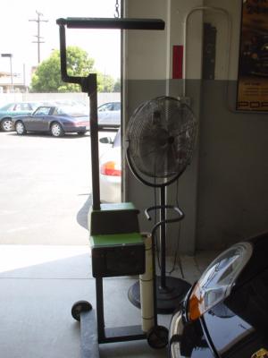

Get them checked atleast. Driving around with unaligned headlights (especially HIDs) is dangerous because you could be blinding other drivers and not knowing it. Your dealer should have a tool to check headlight alignment. It literally takes less than 5 minutes to check.
