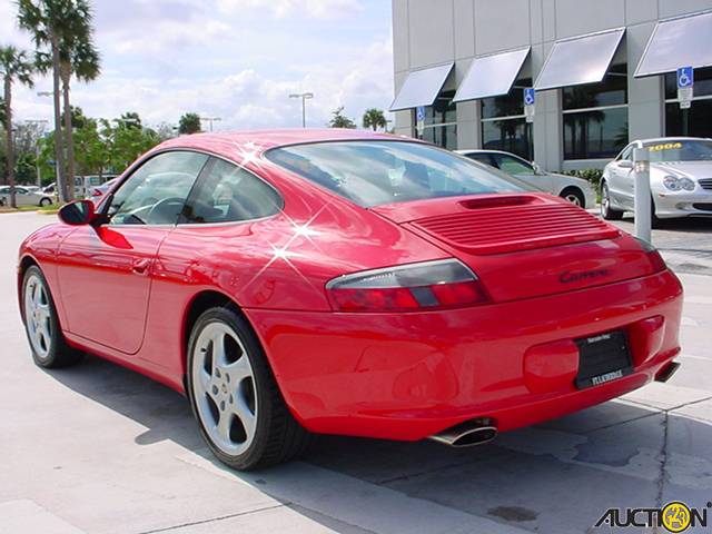

Here's a pic of the car with it's stock rims. Doesn't really look like I would have room for less offset, but then I'm new to this...

The quick and easy answer is that the front wheels will fit fine, it is the rear wheels you will have a problem with. The offset for the C2 is 65 (63 will work as well). The rear has no chance of fitting.

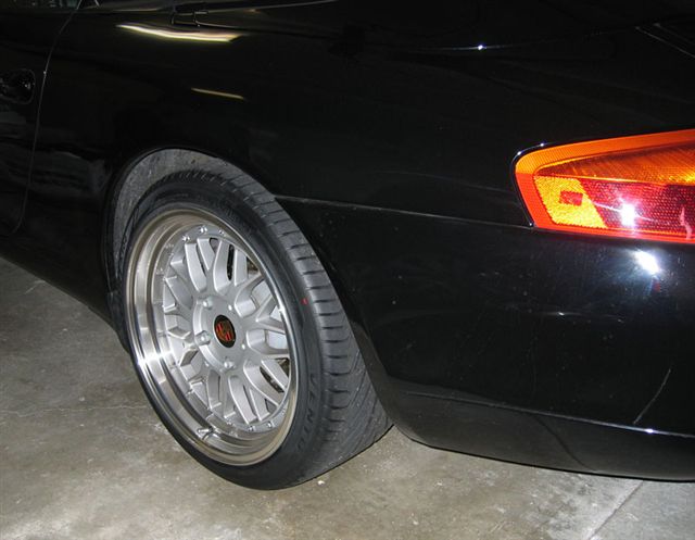

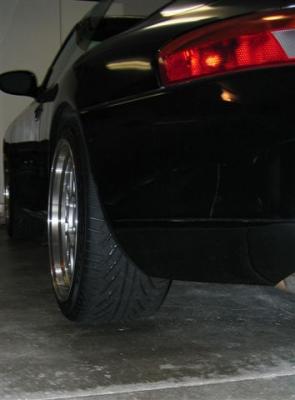

Looks like the wheels may work afterall. I got a message from someone using these exact wheels on their 911 narrow body. He says they don't rub and look good. Someone suggested I could shave some of the hub from the wheel to fine tune the fit... Not sure about that...
