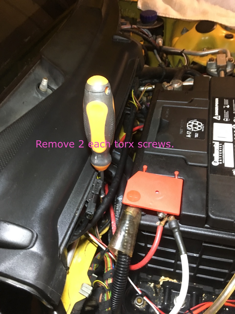

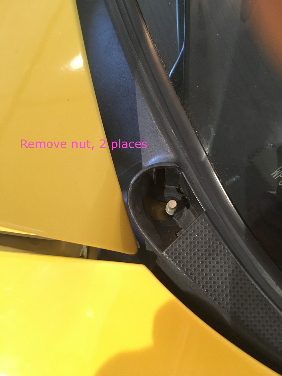

On 10/11/2013 at 11:46 PM, hi8ha said:
It's time-consuming.  I'm lost as to where to remove the servo arm.  Emmett says it's under the center console?  Do you mean it's under the dash forward of the center console?  I don't see any way to get there unless you start removing dash parts.  The tutorial says to remove the kick panel on the passenger side to expose the servo arm?  Can we clarify exactly where the servo arm is for my 996?
Mitch
These are not in order but could be added to the tutorial.
Edited by creekman
Pics were of good size.
Good idea, when I posted the reply I thought it was going to the original post.  Sorry about that...  I just thought bigger pictures would help.  I'm down to removing the mixing door, but I can't get the plugs out, or something is different.
How many people have used this thread to accomplish covering the doors?
Mitch
I've spent several hours trying to remove the 'plugs'.  It appears to me that there are no plugs.  The mixing door is attached to pivot sleeves and there is not a millimeter of up and down per the instructions.  When the door is moved the sleeves move the same amount.  What I see is the door top and bottom is attached to round stock and it turns in the housing. The mixing door was installed between the top and bottom halves of the housing so it's locked in the housing until the entire housing is removed.  That's what it looks like to me.
There are quite a few things that are different on a wide body car other than just the brakes and suspension. Maybe it's 2003 vs an earlier year model?   To get to this point and not get the door out will be a ball buster
Can anybody add to this...
Mitch

I've had the same problem for some time and when my A/C cold air took a long time to come online I decided to follow the tech tutorial...
Warning: my door would come out per the tutorial...  My Vent door is captured by the 2 halves of the evaporator box.  Maybe because the tech tip was based on a Boxster, or my 996 C4S is different it was a bust.
My suggestion is to start under the dash and see if the door is hinged with the removable bushing before tearing into the upper trunk area first
Turned out that I had a very small weep in the pressure side line under the car.  The A/C is now working fine even though I removed a lot of the foam during my try at removing the door.
