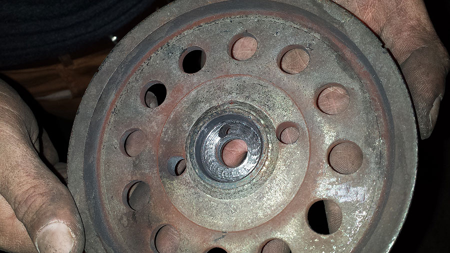

Update.
It was enough to remove the bumper and the heat shield underneath it and also another small plank to actually get full access to crank pulley and its bolt. We were also able to remove the pulley by removing the belt tensioner (bolt on the back, nut on the front). It turned out the crank pulley is all messed up and needs to be replaced. (( The crankshaft is fine however, luckily. The weird thing is that partnumber on the pulley is misspelled: it reads 996 102 170 71, whereas correct number is 996 102 017 71. For my VIN, PIWIS PET shows p/no 996 102 017 72 that fits all turbo range Porsches 996-997.

The old pulley is totally messed up: its mounting place is ruined, and also the cyllindrical pin's place, the whole thing is out of balance which can be observed while the engine's running. :(
