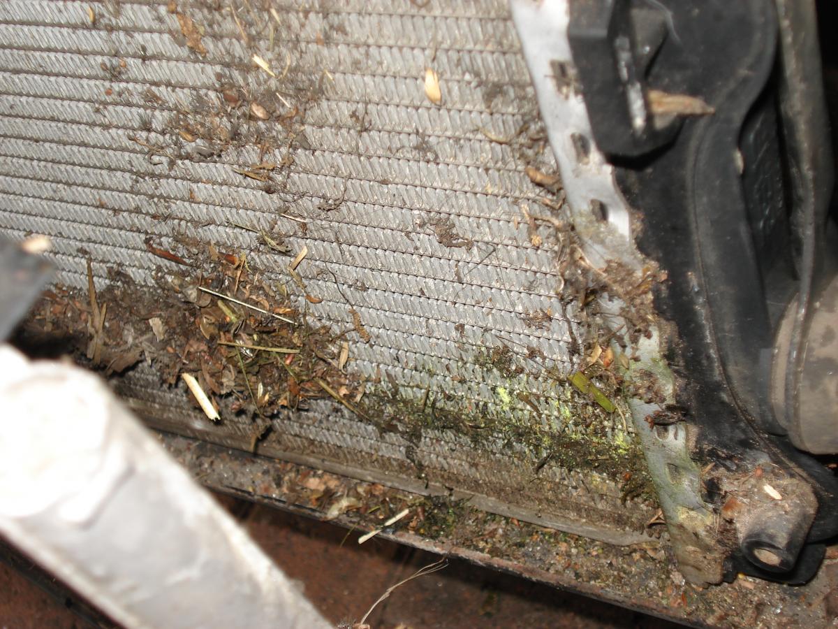

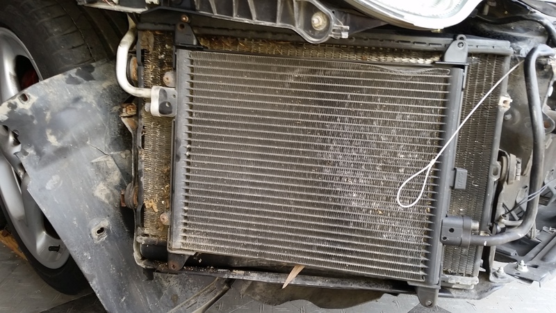

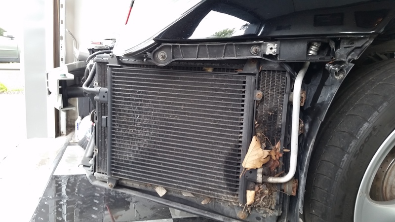

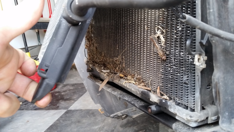

The front bumper cover removal is really easy and give you access for a good cleanup of your radiators. I had to remove the left radiator and the fan at the same time. So here is the process….Hope this will help anyone... Toll needed: Philips screwdriver #2 Torx screwdriver 030 Tork screwdriver 025 Socket 13 and 16mm To do a good clean-up of the front radiator… (Pop rivet gun + six 1/8 diameter pop rivets 3/8 inch long) +++ Cover removal: Take out both side markers. (thin screwdriver p
