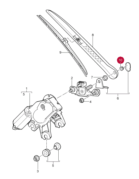

rear windshield wiper do not work
How to check whether windshield wiper motor is faulty itself or problem is in any other component like relay or switch. The water pump starts but wiper do not moves.

Did you close the rear latch switch while keeping the rear hatch open to test? You have to simulate that the rear hatch is closed. Use a screw driver and make sure it is in the secondary position (fully closed simulation) and then test the wiper. Not very common for the motor to be the issue... I have seen the actual mechanical pivot point be very gummed up and stiff.
If the motor doesn't work, are you getting voltage at the fuse?
