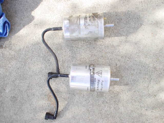

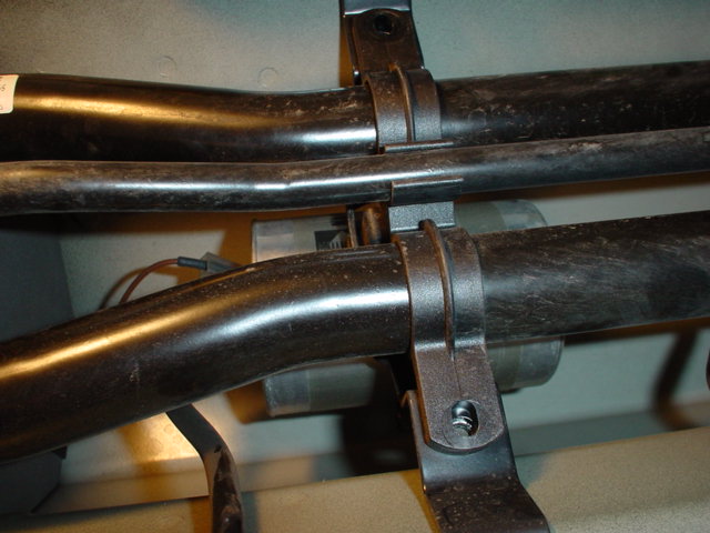

The fuel filter is located in the tunnel area facing the center unit above the coolant pipes.
1. Remove cover for rear and center underbody.
2. Pull off ground cable on filter. Then release the rapid-action couplings by pressing on the grey surfaces and remove the fuel lines. Collect emerging fuel.
3. Loosen the large hose clamp on the filter and remove the filter element.
4. Re-install a new filter element and tighten the hose clamp.
5. Join the rapid-action couplings of the fuel lines. The plug connections must engage audibly. Then push the ground cable onto the filter element.

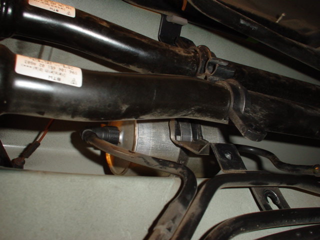

I must be completely retarded because in my 2001 C4 I can't find this **** thing anywhere? I've removed all the center covers and don't see. It's decent sized so how am I missing it? Is it in front of the transmission? above it?
I think on some of the newer C4's the fuel fiter is strapped on the back of the coolant tank in the engine compartment. Let us know where you find it.
If so, then the filter would be here.
On my 2000 C4 the fuel filter is strapped to the top rear of the coolant tank (as shown in your picture). I think I used a 7 mm socket to loosen the strap and slide it out (after disconnecting the quick action hose and using a 17 mm or 19 mm wrench to disconnect the other line).
Edited by C4 Pazzo
Thanks for the responses! It was indeed behind the coolant tank. I spent about an hour under the car searching! What's the point of a repair manual when it's wrong so frequently? This is about the third time I've reference the manual and then when I actually try to do the job the car is different. I broke a switch a month or two ago trying to remove it the way the manual suggested.
